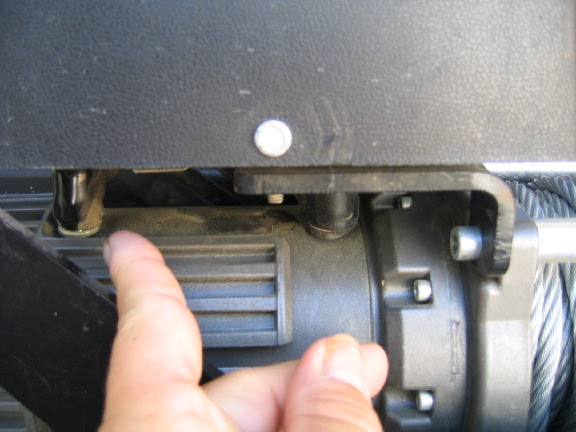

here is a pic showing where to other inputs are connected. This one is a terminal called "A", which likely stands for armature?
As detected, when the winch sits unplugged and with no power applied, this terminal has continuity with the ground. The other terminal, marked "F2" does not have continuity with the ground.
