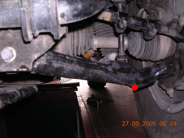

For anyone who attempt to use the torsion bar for adjust the front height. When you increase the height of h2 using the screw under the body, verify that the tie rods dont touch the front stabilizer bar with the two front wheel on air (with suspension at full lenght). I have modified this and i have damaged the pitman arms. why ?
On OR the front wheel go on air, the tie rods touch the front bar and can not move. when the wheel touch the terrain cannot move!!!!
Another question ...what is the height of your h2 (no lift and no air suspension) measured from the ground and the red dot on the photo?
My height is 101 cm. on driver side and 102-3 cm. on the pass. side.

Looks like a lot of positve caster on your set up--could be the angle of the shot?
Who did the front end alignment? Three degrees is plenty in most cases. You may have to much caster?
If you have a lot, your tie rods could touch your sway bars links. Less caster will move the tie rods out from the sway bars--hard to tell from the photo.
Old 09-27-2005, 12:05 PM
Ernie Italy Ernie Italy is offline
Posts: 258
Ernie Italy is off the scale
this is the pics. we have now increased the sway bar connectors... but the lower arms (we call trapezio) have a distance from the ground with stock tires of only 26 cm 10.3" and I have crancked all the torsion bar.. A stock h2 have a clearance of 28 cm in this point.. Someone say that is possible that the first owner (but the H2 have only 1000 km when i have buyed) have change the camm on the torsion bar with another with other design ?!?!?

I am a little confused, granted a little late to the game, but confused nonetheless. I believe you said when the tire is at full droop (tire in the air) is when the tie rod and sway bars hit.
I believe the torsion bar adjustments should have no effect on this since this is a product of the limitation of the suspension, not the pre-load provided by the torsion bar.
It would appear there is the possibility it is the design of those tie rods that is creating the problem. They might not be offering the clearance at full droop that the stock and Fabtech tie rods do.
Posts: 258
From dot to ground... and I have 35 installed. But take a look on the side of the tires. The last terminal of lower arm look to the high.. I think that normal are parallel to ground. Ouch why I dont have studied english in my past!!!!!
