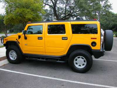

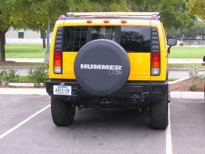

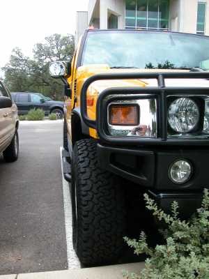

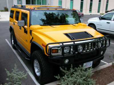

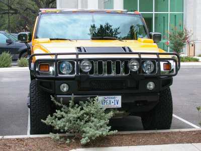

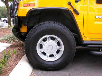

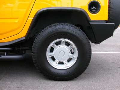

Longhorn:
Here are some reduced shots. Give me an email address if you want me to send you the full-resolution shots.
-Randall Garrett-
admin@apexwin.com

Old 07-28-2003, 08:05 PM
Apex IV Apex IV is offline
Join Date: Jul 2003
Location: San Antonio, TX USA
Posts: 79
Apex IV is off the scale
Last one. Notice how carefully I parked along the stripe??? :-) No, it wasn't because I'm a newbie (my former vehicle was an H1) - It was done to help with the referencing...
