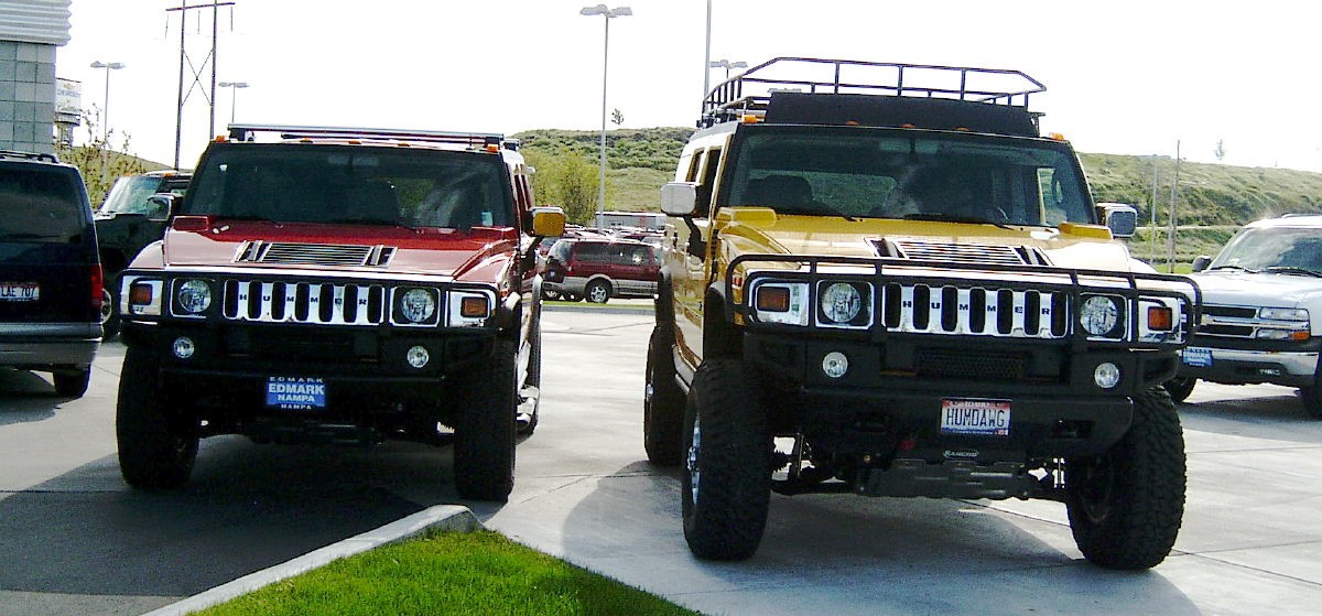

Got some pics of our lifted H2 from the dealer. They aren't very good ones and I will have to take some better ones myself, but here is what I have so far. The Rancho Kit says it's a 4" lift however I measure a 6.5" difference between mine and the stock H2 sitting next to it. I realize that I gain an inch from the 37" Goodyears so that makes the lift over 5".

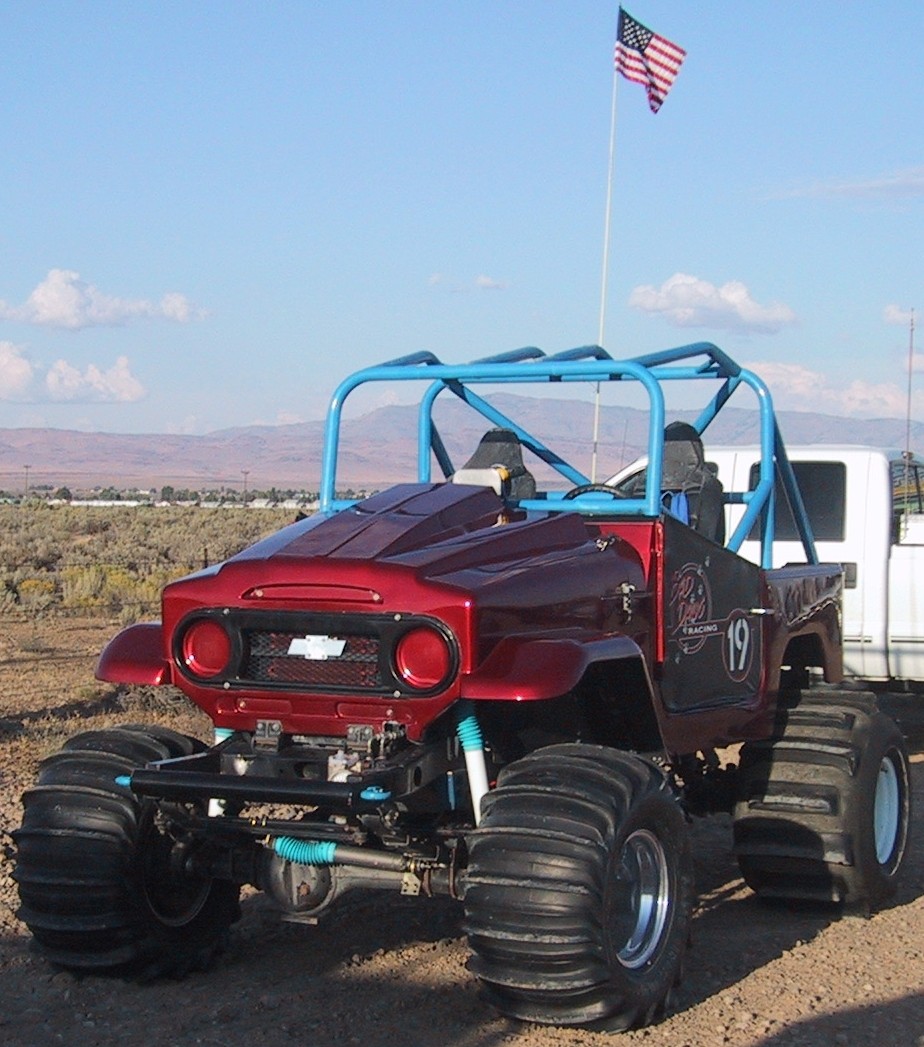

The Land Cruiser is out of control. We run a 541c.i. Chevy (Merlin block) dyno'd at 830+hp. A 2" suspension lift added to a spring over axel conversion when sitting on the 38.5" boggers gives it about 12+" of lift over stock. We are almost done with a frame-off restoration of our 1972 1/2 ton Short box GMC. It has a 4" lift, 2" body lift sitting on 39" Super Swampers putting it at about 11" over stock.The GMC is running our old race engine out of the Land Cruiser that's a stroker 383c.i. in the 500 hp range (not dyno'd).Don't have any shots of the GMC saved on the computer yet. Our tow rig is a 2001 1 ton Chevy Dually Duramax with a Rancho 4" lift only in the front and Air bags in the rear to help with the weight of the 11.5 ft. cab over camper. We have added the "Edge" juice box to the Duramax to bring the HP up to about 390. We run around in the race pits on our Polaris 700 ATV.

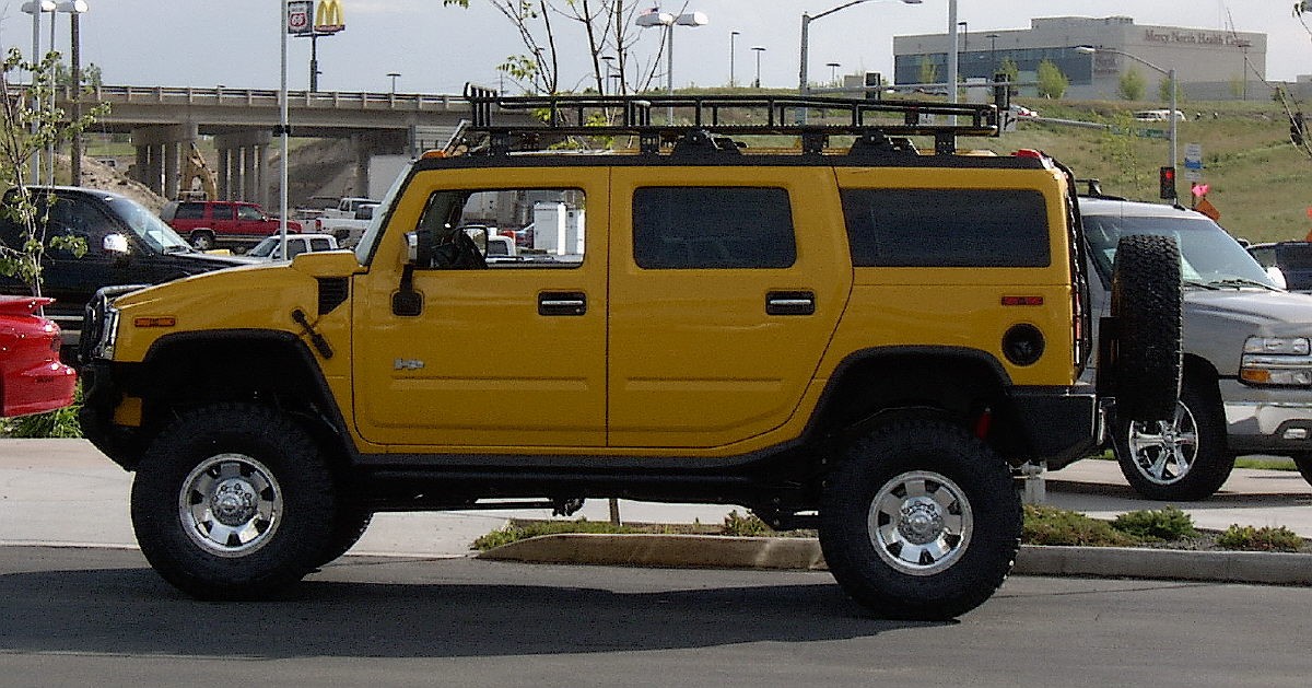

Next.

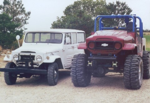

One more of the Dawg sitting next to our LC wagon we just sold to show relative size.

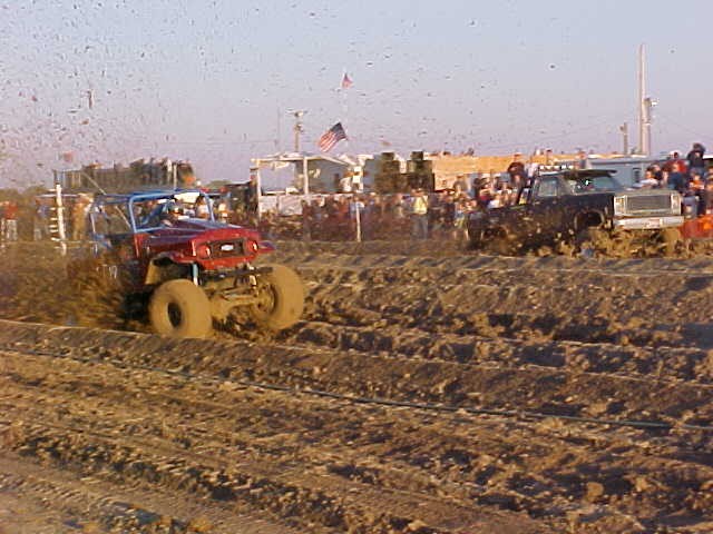

Try again.

Bad Dawg - Looks GREAT! I can't wait to lift mine, I was thinking about the rancho, but after seeing it I think I may go with the Skyjacker for a little more lift. But it looks really good. Hows it ride now? Please fill me in on you're impressions!

Because everything is basically still stock, just moved down, the ride remains the same. The only exception is that the new 9000 series shocks that I got with the kit were dialed in at a higher level because of the higher center of gravity. The H2 is heavy and tends to lean in the turns. The wider wheels and tires help but stiffening the shocks up helps a lot more. Make sure you get the 9000's with the kit and not the 5000's so that you can have the ability to adjust them. I personally like my rigs to be a bit on the stiff side if they sit somewhat high. I assume that you already know that you are required to replace your stock wheels according to Rancho, although I didn't go with the backspacing they suggested.

Bad Dawg, that looks KILLER!!
I think that is the PERFECT height for an H2. Tall, but not TOO tall. I think they start to look a bit silly when they are jacked up too high, but yours looks the way it should have come from the factory.
Nice wheels, too. I really like them.
And you ROCK, btw. Over 6" taller than stock, and STILL no sidesteps!

I am attaching a pic of one of our other rigs...our Land Cruiser we mud and sand drag with.

I too have the Gobi Rack, and have been thinking the 6" might be too much with the rack and all. The one piece main carrier is really why I wanted the Rancho, but I still want little more lift too. And I haven't gotten off road yet, but I can't wait to! Theres really just nowhere around here What rigs do you have the 8"+ of lift on? Heck, tell me about all your toys! And whats with the bowtie on the front of the landcruiser, do you have a small block in there?
