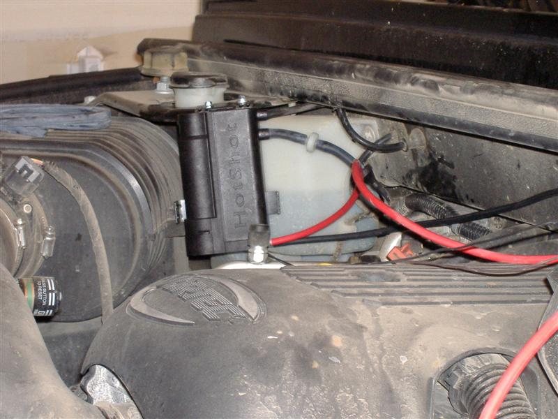

I ended up putting the unit on the firewall, the button on the right side of the wheel and the fuse I attached to the outside of the fuse box:

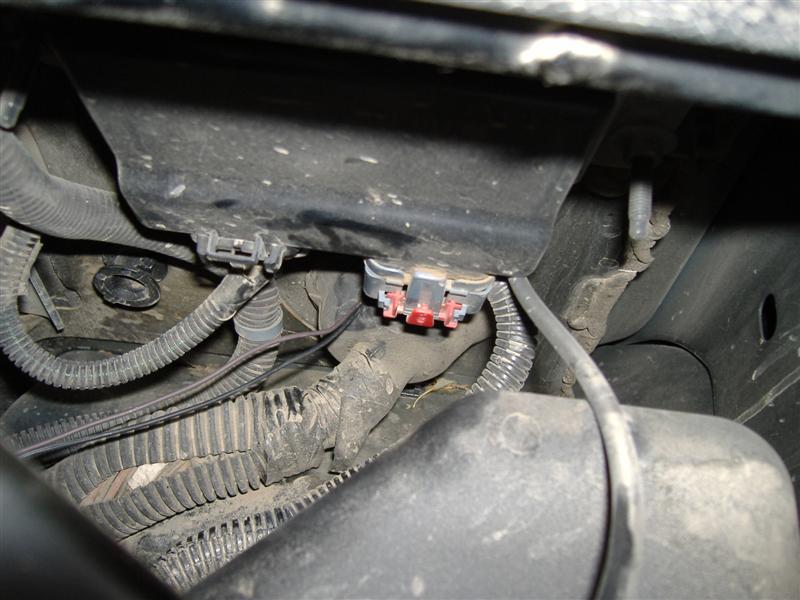

Posts: 2,453
Punched through this grommet without any problems...much easier coming from the engine compartment to the inside...had to move the hood spring bracket out of the way

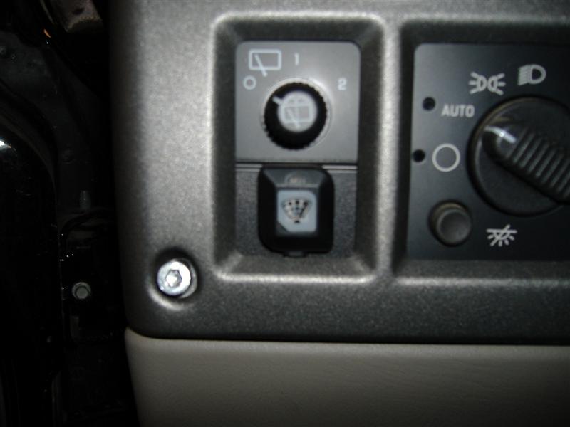

Posts: 2,453
was just about to post the same question NJ. I'm thinking about mounting the button just below the rear wiper control knob. If I can, I'll run the wire right down into the crack. As far as the heating unit, thinking about snipping the side tabs on the bracket, bending the top tabs at 90 degrees and mounting it on the L-bracket the goes around the top of the washer reservoir (where the hood bumper/support is also attached. Unless there's a better idea, I figure it should be enough out of the way..
Other question: which hose do we attach the heater to? The left or the right (the ones to the right of the washer reservoir)?

Posts: 2,453
Ok, finished it. I connected it to the B+ terminal and it works. The only thing that doesn't work is the automatic setting. It says it doesn't have water flowing in when it's on the auto setting. I'll have to call tech support tomorrow. It works just fine manually though. Hey dick, did yours work on "automatic" when you had yours?

Right side.
Ok, got everything installed, but messed up on my power point. I connected to the upper left stud under the fuse cover (I thought there was power, but then there wasn't...don't know which fuse to look at). So I switched to the upper right fuse...it started working, but then stopped. Blew the fuse...it's a 30amp...so have to get a new one. So, now the question is...can I attach the power line to the power post/stud on the left side of the fuse block? The lower one doesn't read power, but the upper one does. It's marked as B+ in the diagram.... Any thoughts before I blow another fuse? (oh, the one that came with the unit is a 60amp...that's why I blew the stud #2. )
