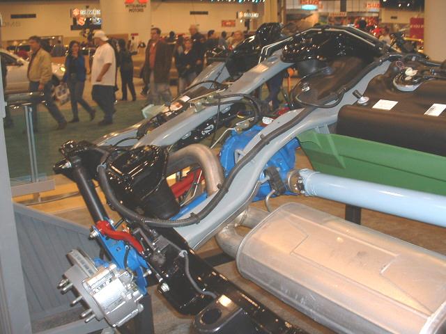

Heres one of the air compressor assy. and associated valving. I think the round object partly visible on the right to right of the compressor motor is a air drier/ filter assy., not sure though.
I was supprised at the size of the compressor. Larger than what I expected. Its rated a 11 amps. and 1/4 hp. motor.

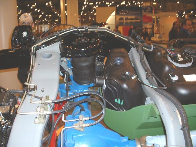

Picture of the rear air suspension bag. The bag is completely deflated here and not resting in its seat on top of the rear axle.

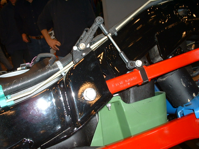

One last shot of the ride height sensor. It sits atop the upper control arm pretty close to the tire.

Here are a few more pics of the rear and some of the more of the air compressor assy.& ride height sensors. It could be easy to damage in some cases, one of the reasons I decided to go with rear coil suspension, besides the coils were $1175 less cost and ride great.
