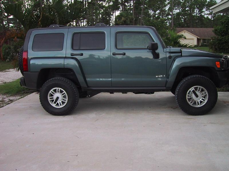

1. I took the floor jack and lifted the front tires off the ground.
2. I marked the bolts for the torsion bars with a red marker to give me an index point.
3. I then took a 1-1/16" socket and gave 5 full turns of the bolt and dropped it off the jack.
The end result...1 1/2" of lift on the front and alot more level appearance. I need to check the headlight aim and toe-in later...
NOTE: No offset keys were needed.

Old 08-10-2005, 09:14 PM
MxHonda MxHonda is offline
Location: West Palm Beach, FL
Posts: 185
MxHonda is off the scale
Leveled...Back is only 1" higher than the front now.

Old 08-11-2005, 01:37 PM
Larry W Larry W is offline
Location: Maryland on my way to Colorado
Posts: 57
Larry W is off the scale
can you give us a couple side pics as well...

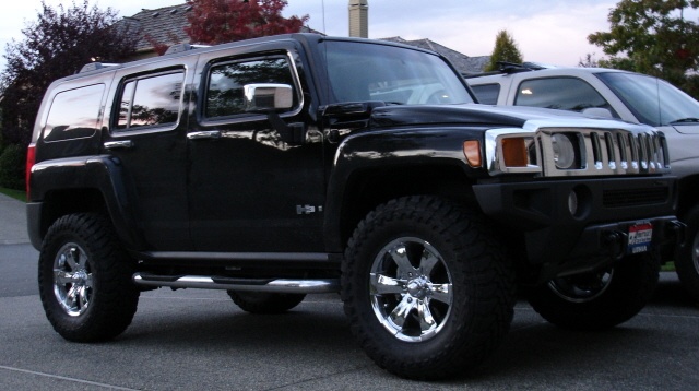

kacyk's Avatar
kacyk kacyk is offline
Join Date: May 2004
Location: The Carolina's
Posts: 1,198
kacyk is off the scale
[/quote]
The ride quality with 2 turns is the same as stock and raises the front to be within 1" of the rear.[/quote]
MX,
My wheels came in so when I get back to Seattle on Saturday I will have them put on my 35/12.50-18 mud tires. I plan on having them turn the torsion nut 2 times (as you ended up doing). Before I go ahead, however, do you still feel that the ride is the same without any ill effects? Thanks, Kacy
2003 Yellow H2 LUX (Sold)
