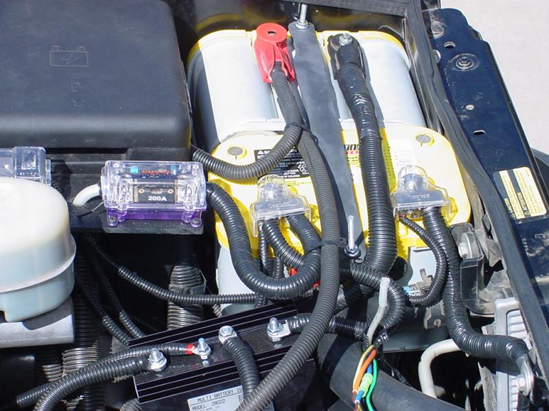

2 loaded sideways, bottom to bottom. Shot from driver's side. (Red tops have same dimensions as yello tops.)

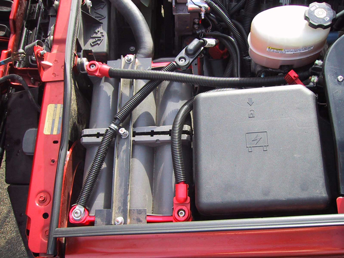

Im thinking of going witht he yellow top too....does anyone have pics of how it sits in the battery spot? is it a very tight fit?

If you are using a dual battery set-up, it's a bit tricky and there are about 3 ways to do it. With one single optima yellow top, it's a no brainer.

Where did those pics come from. I have tried to get with some tray makers to have that exact setup for mine. I want to add a red top to my yellow top for the cranking amps. The yellows are not enough by themselves if they are a little drained and it gets cold. They don't have the suggested cranking amps that the H2 calls for, so I was wanting to do the Red/Yellow setup with isolation and it looked like it would fit like those pics but I was going to try to fab a tray myself.
So, the question is where?

What are the 3 ways? There is the Wrangler setup that Drty has, but that uses smaller capacity batteries (plus I can't use the yellow optima I already have). I have contacted a few dual optima tray manufacturers to see if I can get one custom made to fit but never got anywhere. There was one that might would fit but I never heard back from them.
I am not fond of running a 4 gauge cable the length of the truck to put a battery in the back. Too many opportunities for a short while off-road.
Also, there is little to no room under the hood. Ideas?

One upright, one sideways. Shot from passenger side.
