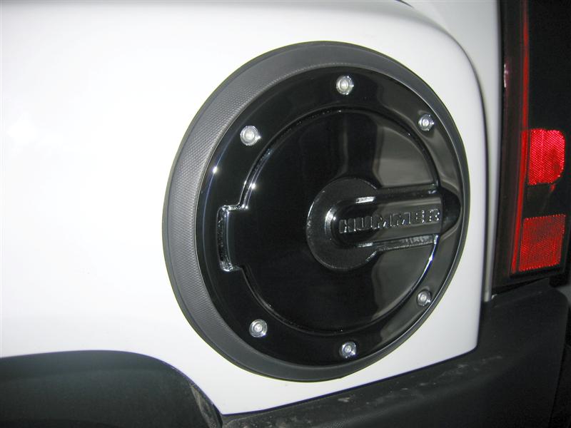

Anyway here is the new door, notice that the outer bezel matches the texture of all the other plastic trim and bumpers on the H3.
I would say, if you are unsure of templates and drilling, have the dealer do it. If you read the directions and take it slowly and check twice drill once, you can do it.
ALSO A NOTE: ONCE YOU PUSH THE UNIT ON, YOU CANNOT REMOVE WITHOUT CAUSING DAMAGE. THE PUSH PINS ARE A ONE TIME DEAL.

Here goes
You pry/remove the original gas well with a plastic putty knife. It just snaps in.
You get a template and drill 5 hole around the edge. You get 5 speed nuts that go in the holes and stop.
There are 4 plastic fingers and 1 metal guide stud.
You light put the unit with the outer bezel on, until it stop. Open the door and from the inside there are 5 holes in the side, use a "L" shape allen wrench and hold each speed nut and put till it snaps to all five. You will know it's seated when the rubber washer around the bezel is flat..easy

The only thing is re-packaging to include the lock cap. To many people complained. Price may only raise a few buck only THAT IS ALL

Thanks Georgemarc. Does it look like H3Lady's or is it a custom H2 to H3 job? I only ask that as my dealer said it's either custom or aftermarket knock-off as the "licensed" ones have been recalled.

It is the same as H3Lady's and I believe it a custom H2 to H3 job, looks good.
Will get a closer pic of it out here soon

Just a reflection, it is bright chrome and boy does it look good. I have the locking cap too inside.
it will keep out the elements and keep this area clean.
hey, if you had the dollars you could have the door power coated or black chromed. It does seperate from the bezel easy BEFORE INSTALLATION

Here are photos of the GM Hummer chrome fuel cover (GM Part number 12499618) that we had installed this past Thursday by our dealer. It seems to have the same textured outer bezel that H3Lady described. It is attached by 5 screws, and I think they did a good job on the install. I feel lucky that we were able to find one, and hope there is not a problem with the design, assembly, etc.
