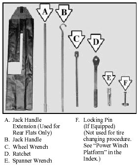

Old 01-15-2003, 12:58 PM
Big Z Big Z is offline
Posts: 1,216
JCJ-The pin that comes with the set-up will not work. Use the pin that comes in your Tire Kit.
Old 01-15-2003, 01:52 PM
JCJ JCJ is offline
Location: Aruba
Posts: 349
JCJ is off the scale
Big Z. Thanks.
Part F? Page 5-20 of manual.
My H2 didn't come with that nor the hitch receiver extension!
