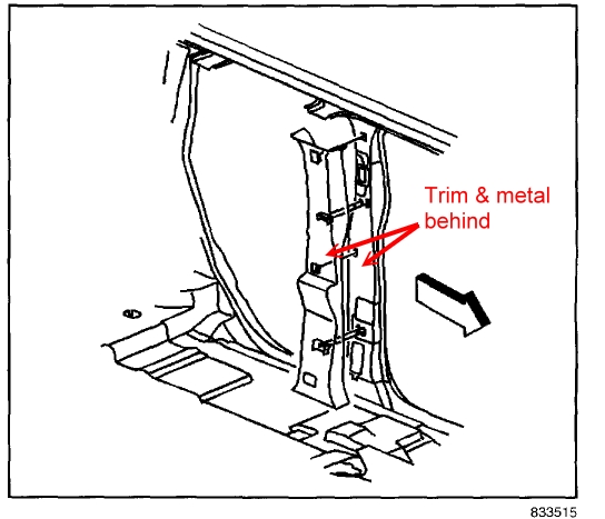

Tower, just outboard of the front seats on the B-pillar. You can mount something like a small extinguisher or a flashlight on each side there. There is also a little ledge in the plastic just above seat high on the B-pillar that cold be utilized for something. </div></BLOCKQUOTE>t~ I think this is what Paragon is talking about & looks like a good place if your equip. is not too large.

Here's some instructions on removing the trim:
1. Remove close out panel at the top of the hinged pillar trim panel using a small flat bladed tool.
2. Remove the retaining screw.
3. Firmly grasp and gently pull to disengage the retaining clips.
4. Disconnect the lower lamp wire connector.
5. Remove the hinge pillar trim from the vehicle.
6. Inspect for broken or missing retaining clips and replace as necessary.
