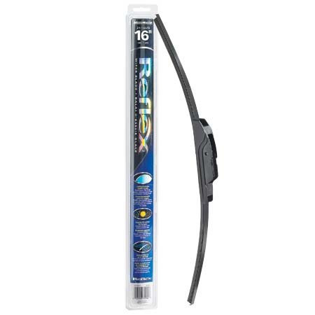

From the factory, blades sizes are 16.7 (driver) 15.7 passenger. I originally purchased Trico snow blades 17 (driver) 16 (passenger) and they fit great. However, Trico blades are, terrible, and right away they started to streak.
I eventually replaced both with 16 inch Anco snow blades and that solves the problem with them icing up inside, causing streaking and generally poor wiping conditions.

I live in the great white north and I swear by flexible wiper blades. They never freeze or streak. It will be one of the first additions to my Hummer when it finally arrives. Man, 8 weeks is a long time when you are waiting for your H3.
