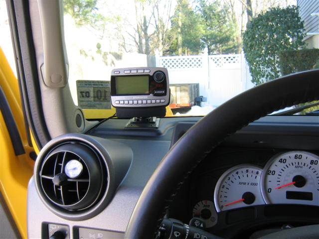

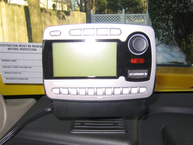

I just picked up the Sirius Sportster last night. $129.00 at Circuit city complete with car dock, antenna and cigarette lighter power cord. If anyone has pictures of a portable satelite radio install please post them. Here is a picture of the unit I got.
Old 02-02-2005, 06:46 PM
Spike Spike is offline
Location: Whereabouts unknown
Posts: 2,267
Satelite radio is installed, up and running. Installation was a breeze. It took me longer to decide where to put the unit than the actual install. I'll post pictures in a few minutes.
Old 02-02-2005, 07:05 PM
Posts: 2,267

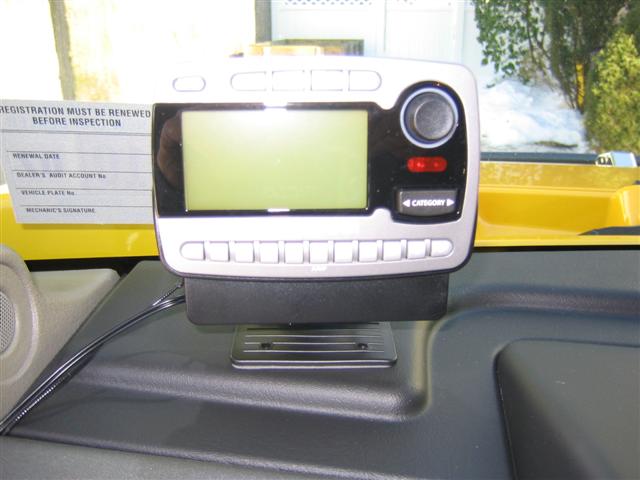

OK gang, here it is. Sirius Sportster Plug and Play Satelite Radio. It truly is plug and play. I didn't need any tools for the install except 1 phillips head screwdriver to screw the docking bay to the mounting base. I mounted on the dash to the left of the steering wheel. This way it did not impede my vision. I tried it in the center above the 2 vents and it does impede your vision to some extent.

Close up view

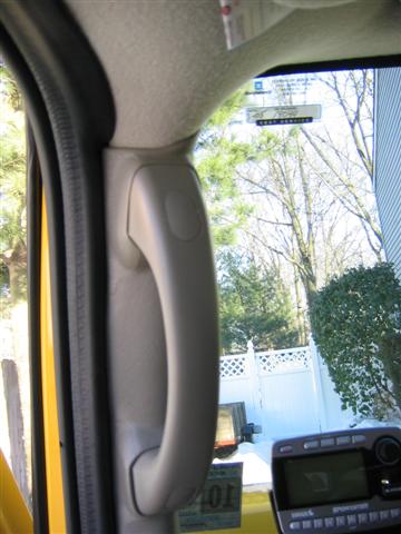

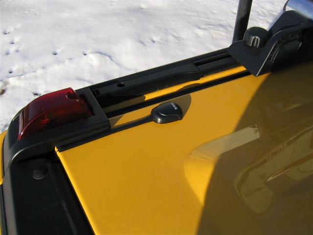

Antenna mount on roof
Old 02-02-2005, 07:11 PM
Posts: 2,267

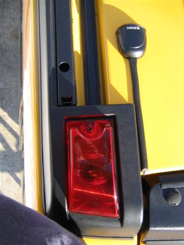

Another angle antenna mount

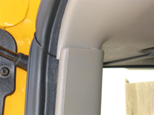

I ran the antenna wire up inside between the rubber moulding and the headliner up the entire driverside of the vehicle.

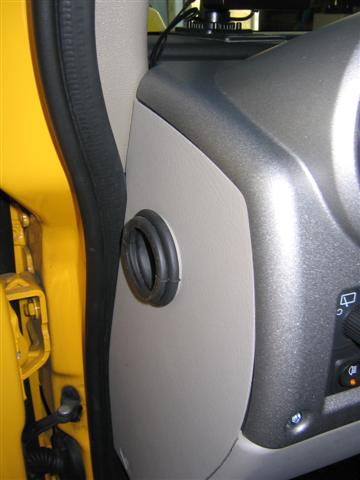

Then I removed the pillar garnish and ran the wire down that and out the bottom to the unit.

where wire came out from pillar garnish and goes into unit

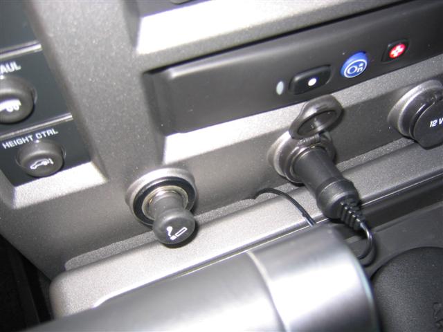

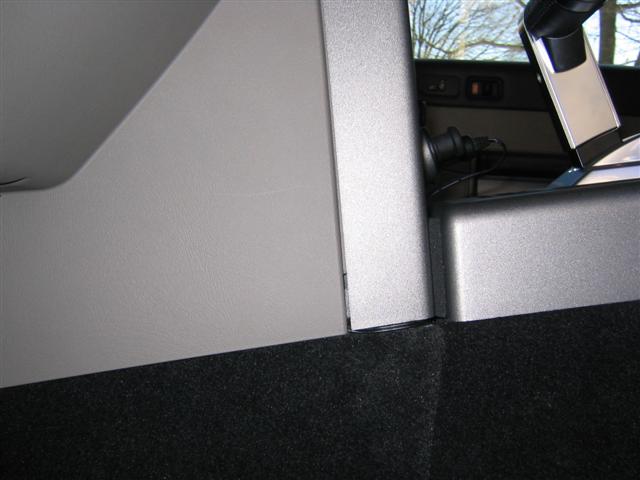

Next I ran the power cord into the same opening as the antenna wire but then ran it down the side of the dash behind the acess panel
Old 02-02-2005, 07:21 PM
Posts: 2,267

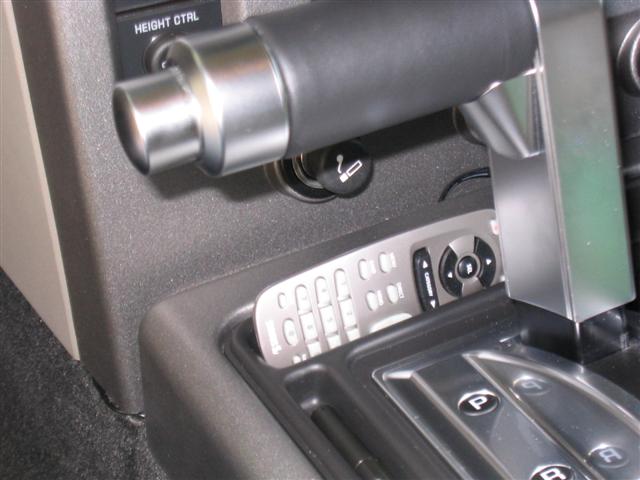

Then I ran the power cord across the bottom of the dash around the base of the center console tucking the wire in where the console and the carpet meet.
Old 02-02-2005, 07:22 PM
Posts: 2,267
Then I ran the wire behind the foam between the console and the dash and out in the middle and into the cigarette lighter plug.
Posts: 2,267

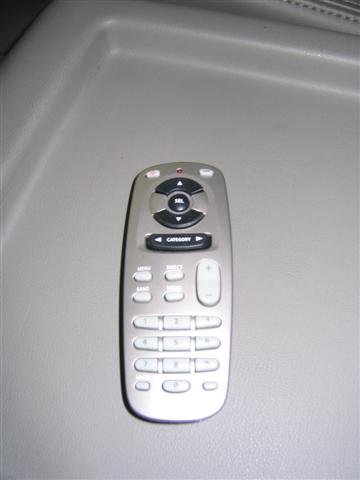

Remote
Old 02-02-2005, 07:23 PM
Posts: 2,267
Fits perfectly in console recess
