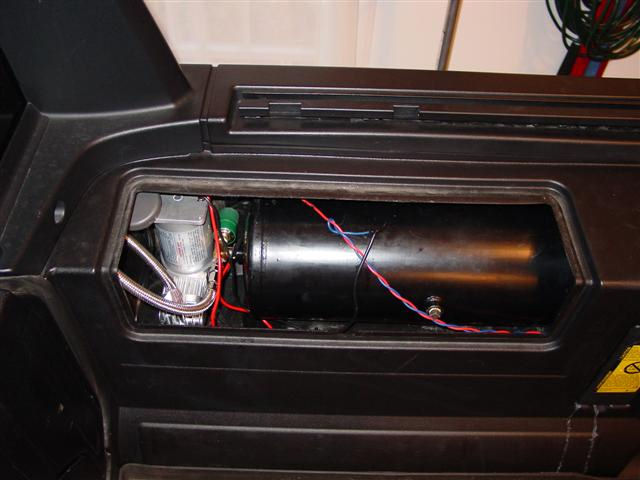

Did you buy just the horns or their whole kit? That compressor/tank combo is a P.O.S. Mine blew up in the first week. They still owe me a new one and its been 3 months since I RMA'd it.
I mounted a 3 gallon tank and a Viair compressor in the jack compartment. I actually have a new tank coming with 1/2" ports to accommodate the new 1/2" line and valve I bought. The jack & stuff is under the back seat now.

Ok, just making sure I'm not wasting air by having the pressure up to max.
That pic is of the current setup. The new tank is chrome. It was the only one I could find with 1/2" ports in the dimensions I needed. The valve is an Xtreme GC 250
I plan to put the valve right before the horn manifold.
Hopefully the stuff will come today or tomorrow so I could do the upgrade over the weekend.
