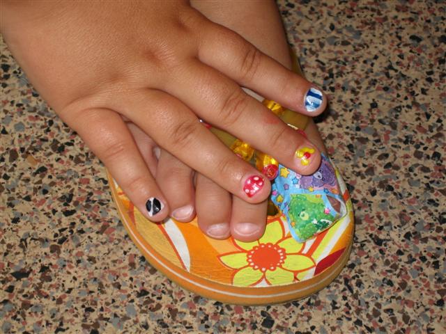

That looks a lot like what we had done to our garage. Tough as nails and a very crisp look. Cleans easily with a mop or power washer. It may be easy to do but after watching the install, I'm glad the flooring contractor did it for us.
This is the best close-up picture I have.

Old 10-22-2005, 01:45 PM
Rod, I didn't take you for a flipflop kinda guy.

Rod, I didn't take you for a flipflop kinda guy. </div></BLOCKQUOTE>
And I thought the Care Bear Band-Aid was adequate camouflage.

Old 10-22-2005, 02:27 PM
And I thought the Care Bear Band-Aid was adequate camouflage. </div></BLOCKQUOTE>
No kidding, I thought someone was missing a toe.

Rodster you have this floor, how was it cost-wise? It looks like they can do patterns. I don't know if they can do B/W checkers but it looks pretty nice with a couple different perimeter trim colors. Thanks for the pics!! </div></BLOCKQUOTE>
The garage floor was part of a larger flooring project so it's difficult to put an exact number on it. If I had to guess: 800sf for around $1,500. Not bad.
It would be easy enough to do a different color trim around the edge. Checkboard could be done but that's a much bigger job. The floor is first cleaned (etched, I think), then a base color goes down, then colored flakes are scattered, then clear coat. The checkerboard would take a whole lot of masking during the base coat and flakes stages.
