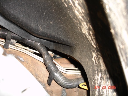

It was the tires. Front Driver tire managed to get into the large loom that is attached to the frame. I can see the rub of the tire on the frame. It opened up the loom but only ripped three wires. I will photo it when I get home. The dealer promissed to send the pics tomorrow. Basically $103.00 to reattach a few wires and tape up the loom. I am not sure if the loom can be relocated because of the exhaust manifold (don't want to get it any closer to that). Wild stuff. I cranked the wheel as close to it as I could, but I had about 5" of clearance, still. I am guessing that the gap is gone when we articulate a bit. I have a big rub on the frame to prove it???

Well here is $103 worth of repairs. Some black tape. I have not received the before pictures yet, but you can see the rub mark on the frame.
