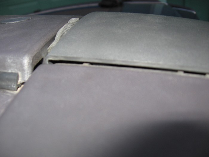

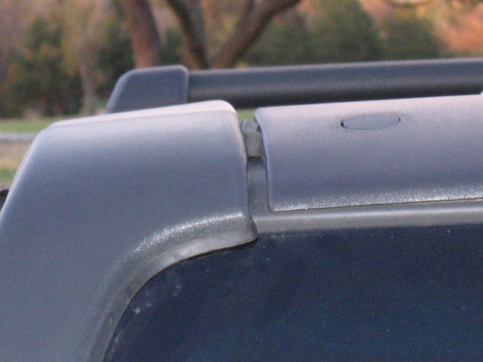

My wind noise/rattle was coming from the passenger side roof and started at 40 mph, it was driving me crazy! I have the off road lights and found that it is the plastic piece where the off road lights join with the piece that runs down the side of the windshield. You can see I fixed the problem by wedging a piece of rubber so the thing wouldn't rattle. See pics.... I'll be taking mine back to the dealer in the next week or so, unfortunately I have to go to a Chevy dealer since all the Hummer dealers are sooooooo far away.

Fron view
