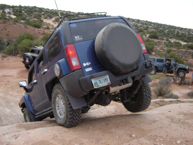

Originally Posted by fw888
dude, there is a lot of air coming out from the tire, we are talking about from 40 psi, and air down to 15 to 20.....would that hold a 5000 lb machine ??
35-36 on the street
and 17-20 in MOAB, UT - works everytime.
Name:  Moab Summer 2006 034.jpg
Name:  Moab Summer 2006 016.jpg
