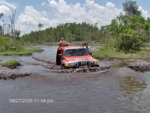

Is that a red crocodile I see in that swamp or is it just me???
Nice photo!

Yeah...they did give me an 07 horn.....and that pic of me in da water...that was not the deep part...it was pretty deep...I was very apprehansive about going furthur..but I went through with no prob.....that pic of Hummernewbie is awesome!!!!!

I'll have to mention the horn next time I go in. After running through a bunch of water a couple weeks ago my horn barely works too. They must have given you an '07 horn, supposed to be louder.
Where is this pic at? it looks familiar....

[quote=HummerNewbie]I'll have to mention the horn next time I go in. After running through a bunch of water a couple weeks ago my horn barely works too. They must have given you an '07 horn, supposed to be louder.[/QUOT
I meant where was ur pic taken at?
Old 10-20-2006, 03:09 AM
Default Re: HIGH water
That was taken in an area near Titusville a couple of weeks ago. I will post more tomorrow, they are on my laptop.

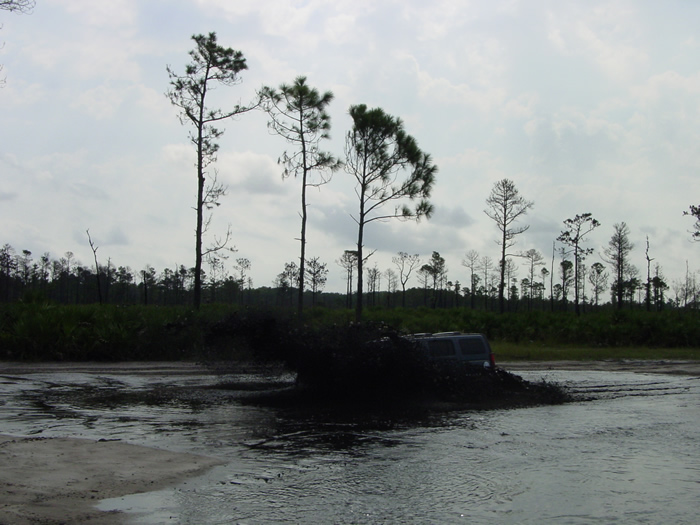

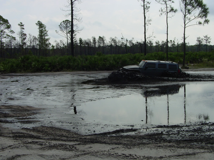

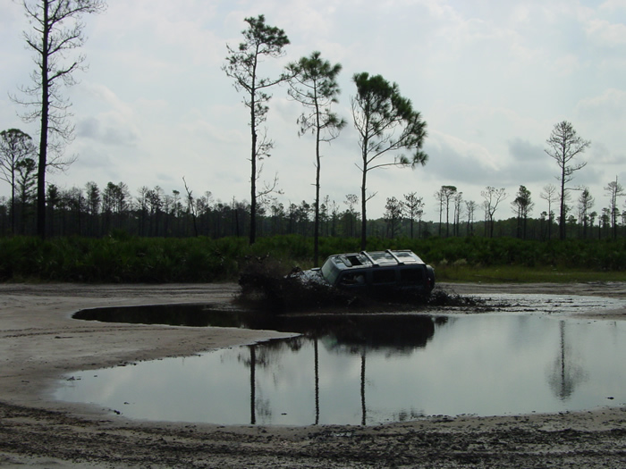

As I recall, yes
A few more pics from a couple of weeks ago.
He closed his sunroof after this one
