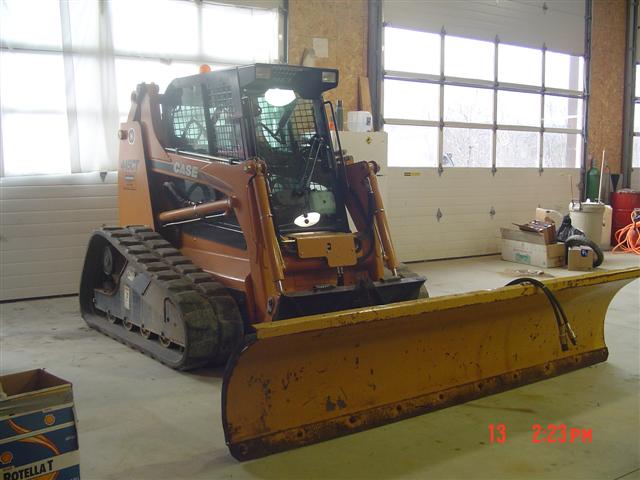

The most towed would prolly be around , 12 - 13 thousand lbs. But i have towed around a skid steer that weighs 9000 and 1500 lb trailer and it likes it. This is a pic of the machine i have towed sometimes.

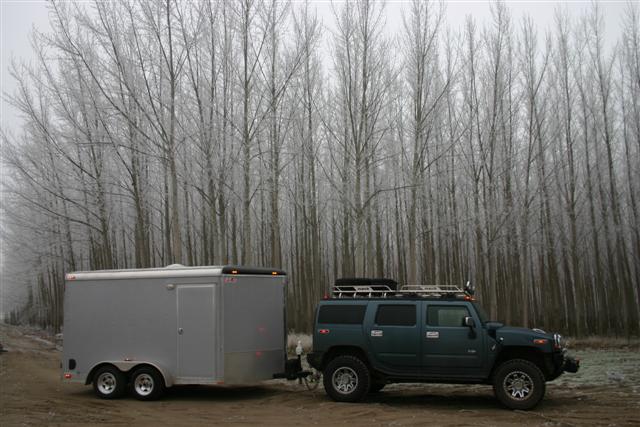

Yes, it will pull it. You'll appreciate the fact that the boat is level on tandem axels. The H2 will work hard and shift all the time and in warm weather watch your tranny temp. It's not a diesel pickup or anything but 6500 lbs isn't too bad, especially if your not towing it very far. Don't forget to add the weight of fuel, people, luggage and beer to the equation. Expect to spend the whole time in second gear when ascending any hills. (even little ones or a headwind) Larger tires only make it worse.
The towing button is helpful at first because it changes the shift points. Sometimes it keeps it in second when you want it to shift tho, so I just turn mine off most of the time.
My husband is on the boat forums a lot, and they have discussed the H2 and it's pulling capacity in detail. Basically, they're using Excursions and pickups and such but some folks pull smaller boats with them without any problem.
Have fun and post a pic of the boat behind your Hummer in some warm sunshiney weather please!
Here's a pic of the trailer I pull everywhere. How much it weighs depends on whats in it. I have pulled bigger things, but very rarely because we have another rig we can tow with.

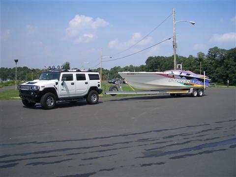

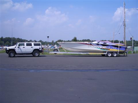

I have towed a 33' powerboat with the gas tanks full. I estimate the weight to have been about 8,000lbs, and my truck did just fine. On the highway I got between 8 and 9 MPG, with the A/C on. It would definitely downshift going up any hill, and the steepest hill near my house caused it to downshift to 2nd, but that was the worst of it. I have tried to attach two pictures below. We'll see if I did it right.
Name:  CIMG0251 (Custom).JPG
Name:  CIMG0252 (Custom).JPG
