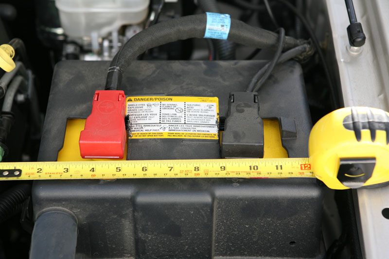

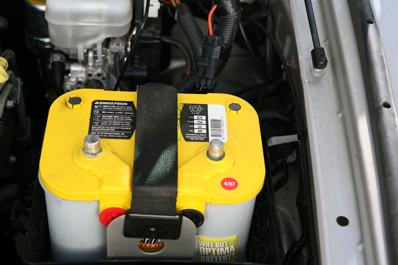

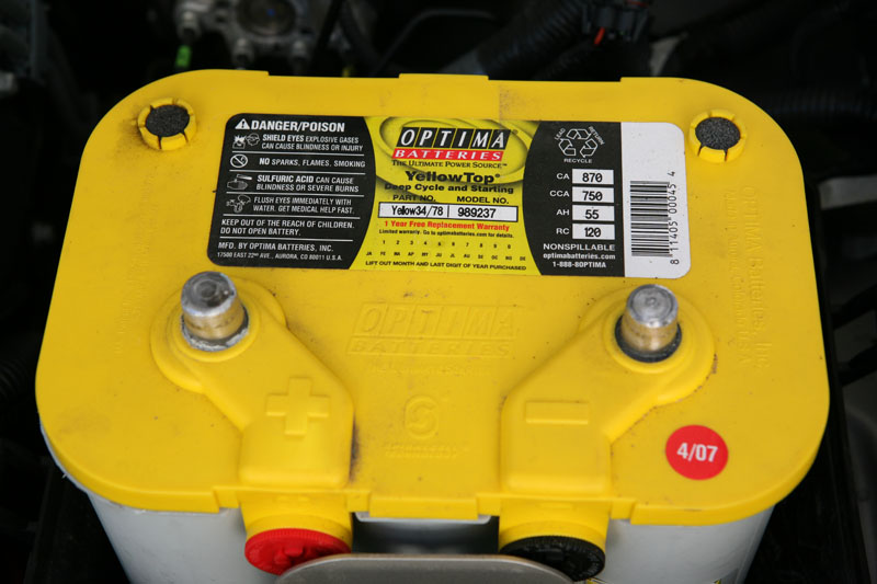

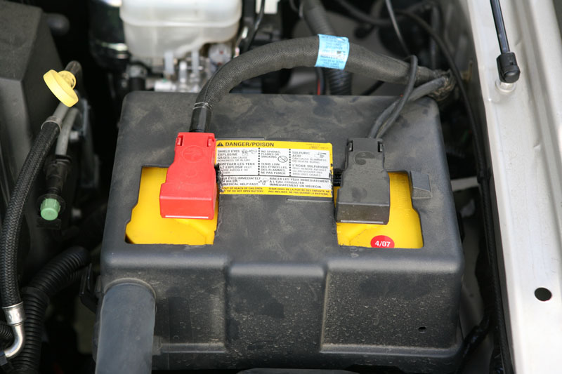

Sorry for the delay, I was sick all last week. Here are some pics.

Thanks for pics, looks tight to fit my light.
Maybe they have one with the posts more apart.
When Im ready I will have to look into it.

Here are some pics.
Hi JeffW,
I see you had to mod the battery box lid. How about the bottom tray--did you have to trim away the little tab/reinforcements (on the terminal / length ends or all around)? Did you mod the "puck" (where the bolt affixes the strap)?
My smaller Red Top with a BCI of 25 didn't require the tabs to be cut, but would have required the lid to be cut (if I reinstalled it). I also had to make a slight mod to the "puck", so the strap would tighten against the smaller battery. Now, I am thinking of upgrading to the Yellow Top. Weird thing is your model has 750CCA, but the same model here in Europe is 690CCA.
mountainbiker
Yes, I had to trim the back two tabs to about half their original width. I did make a modification so the strap would be snug. I didn't modify the puck, though. I suppose that might be a good way to go. Instead I just put some strips of lattice fence wood on top of the battery underneath the strap.
