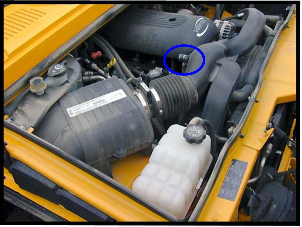

I am at work but I think the H2 has a filter minder, in the pic above look at the little round tube coming off of the plenum between the bellows and the 'Vortec' on the intake cover.
The filter minder goes from clear to yellow to red as the filter is restricting the airflow more.
U push on the end cap to reset.
This should be covered in the manual.

I must have done something WRONG, I got a pic to post finally.
