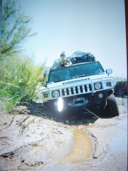

Originally Posted by BradO
I have air suspension and 37's on my H2. They will fit until you flex and compress the rear. Then they are just a little wide and occasionally hit the sensor arm unless you reverse it. I am running those Toyo's currently on a 17in wheel with a -6mm offset which compensates spacing for the wider tire. Otherwise go with a 12.5 wide tire and you'll be fine on stock wheels.
Is -6mm offset correct?,
what is size of the rims?
Iv'e gotta get something wider! These are 12.50s.
Anyone else running 13.50 w/air on aftermarket rims?
Nice sunroof.
