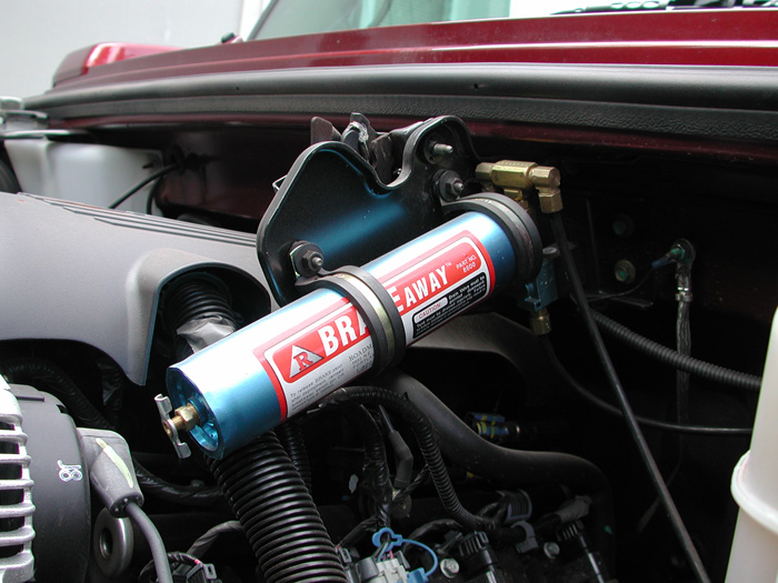

Well, Guess I'll pipe in again!
Flat towing is the BEST way! My 2 was the FIRST towed (prototype) for the roadMaster set up! I haven't read the link yet but I can Guarantee it was the RV/towed H2's fault!!
They most likely Didn't have a Brakeaway Installed OR A BRAKING SYSTEM!
Their's a LOT of ****Heads out there that that don't have the proper set-ups!

I've been rollin for five years now!---Just left RoadMaster with a with a clean Bill oh Health!
If for some Stupid reason the Drag Chains Broke, the lock pin wasn't install or Broke! A pin is pulled and the Brakes in The 2's lock up!
This Guy's FKED!---And shouldn't be, or have been on the Road!!
Another thing, if the drags were installed!, and properly The H2 would have went the other direction!!
That's the first thing I thought. Why didn't it have a brakeaway like yours. Sounds like the guy didn't properly invest in a tow set up.

1.) towbar has a 10K rating
2.) Brake Master--Air Proportional Braking System--
3.) Brakaway Installed!
4.) Drag Cables installed correctly
5.) I DON'T Play RoadMaster Happens to Fail!---My Chit Works!--I do what it takes to make er SAFE!!

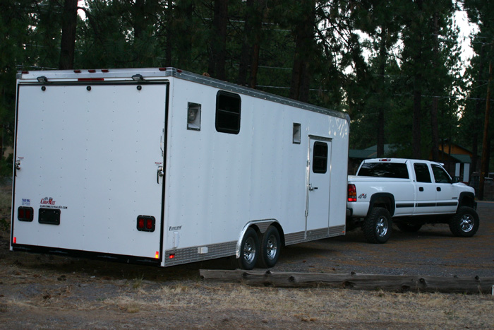

In the Example I used, The car Hauler is rated @ 7,000 pounds, if the Hauler/trailer weighs 2400 pounds empty, what you can put on it (car/payload) must Not exceed 4600 Pounds!----- 4600 + 2400=7000
Nothing to do with the RV!

Here's another Example for ya!
My hauler is rated for 10K, (9,950) Curd Weight = 4,732 Paylosd can be 5,218 Pounds
Tongue Weight is Maxed @ 1000 Pounds On most rigs---475 is speced! on this set up
