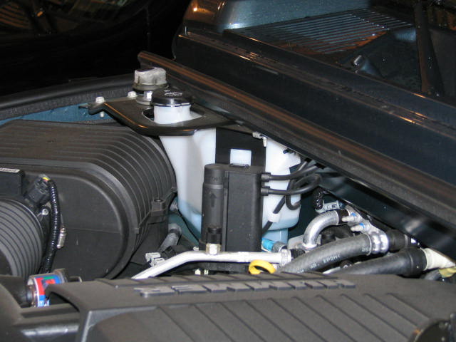

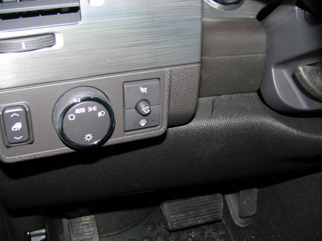

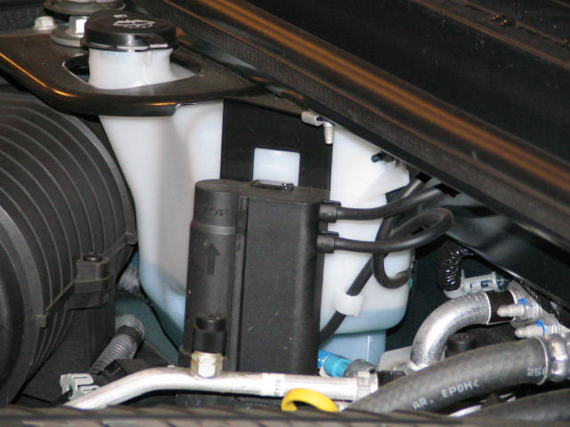

T - here are some photos of the install under the hood and also the switch on the dash. The switch on the dash is a combo switch, the top part kills the interior lights when the door is opened, the center round one controls the dash lights and the lower 1/2 of the switch is the heated washer fluid switch and indicator light.
The under hood unit is mounted with a bracket on the drivers side of the washer tank. There are some pretty girthy wires running into the unit so it must draw quite a bit of juice.
Kinda hard to get a good shot where its located and all the other stuff in the engine bay. I guess I could rip out the engine and get you a few better photos...LOL
Hope these help!

Mikey. YOU RULE! That was just what I needed. Although I'm hoping someone with the LIMITED EDITION will post shots of their switch. (With the radical '08 change to the interior, there is no way for me to duplicate your switch set-up.) Thank you for your trouble. I look forward to the shots after you pull the motor.

T - I kinda figured my switch set up would not be useful to you due to the interior change. I dont know anyone with a LE to even look at one to see. Doesnt that guy that was promoting those ipod adapters have a blue LE? I seem to recall that.
Glad the under hood pics helped. Well guess I better get working on pulling the motor out...just hope i dont have any extra parts after I put it back in!

Thanks for those pics Mike. That helps for the underhood shot.
The LE switch just goes on the front facing AC Pannel. That one is easy. You can fuse the switch inside the drsd dash also.
