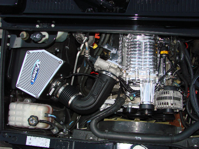

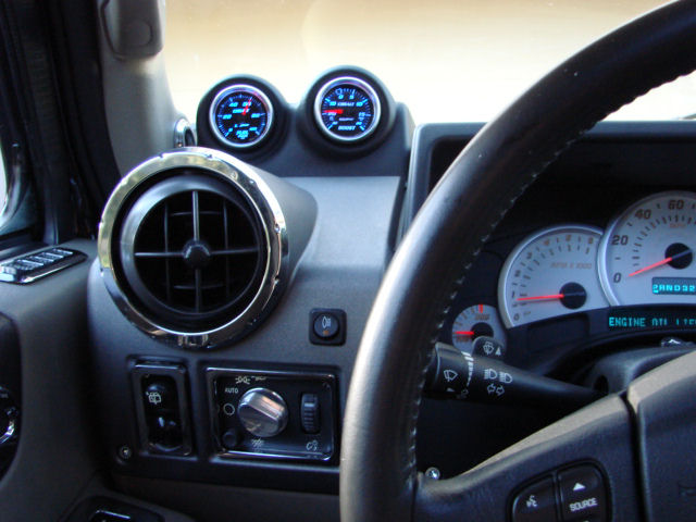

I installed the magnacharger supercharger back in Sept. 07 and love it. Boost between 6-8lbs. Installed corvette servo's as well as boost and fuel pressure pod, and have had no problems. Awesome torque on the low end and enough to let you pass someone with authority on the highway. Gas mileage went from 10 to 7 and now I use premium..Since it's mostly for show, I don't drive it as much, which makes it more fun when I do..Other adds, Dynatech long tube headers, Volant CAI, Bassani dual exhaust, QTP exhaust cutouts, MSD wires, plus, plus, plus..BRUTE
