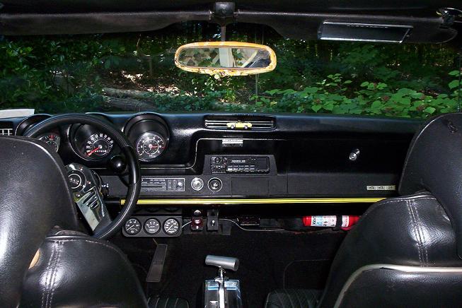

I would buy a new knob/shaft and cutomize it and swap it and keep the original one.
Anyone know if you can put a handle (T or something similar to the H2) on a automatic shifter ?
I put a Hurst T handle on my 442 (TH400 auto,shift kit)
