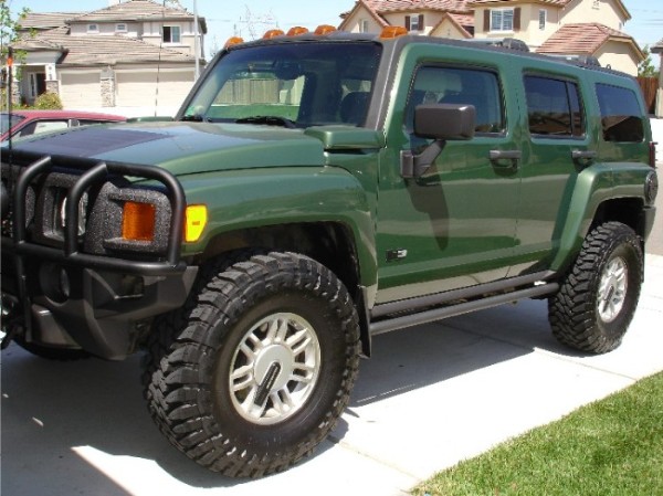

GL: What kind of tires do you have on there?
They look like GY MTRs, but I can't tell for sure.

Very Nice, TGL!
How doe you like the Dupli-Color truckbed coating for the lights? I picked up a can and am considering doing the grill with it.
The stuff your grill is done with seems, for the lack of a better word, "glittery"... Is the Dupli-Color stuff like that too, or is it more "flat"?
Excellent work! Truck looks great and I love the H3 emblems!

They're Toyo Open Country MT's - 315 75 R16.

looks awesome!! cant wait to see the black wheels!

Thanks, I wouldn't recommend using that on the grill, because mine they used "hot spray", they will last longer.
Dupli-color truckbed coating is flat black. Yes, my grill looks glittery just because I put tire shine.

looks good TGL!!
love the way it turned out.

I am waiting for the rims, I am pretty sure I will be blacking out the rims on my Superior Blue and adding a black gas cap cover. How did you hook up the fog lights you mounted on the brush guard? I really like it

TGL - I don't want to make a mistake here... Why don't you recommend this? Does the Dupli-Color stuff seem fragile or brittle? Did it not work well for the lights?
I'll spring for the line-x, but would rather save 80-90 bucks if possible. BUT, if the Dupli-Color stuff is going to fall apart...

Well, the Dupli-Color is basically a cold spray, coming out of a pressure can. Spray On Bedliners or Line-X uses a hot spray. It dries rock hard and will last a long time. They also have a large spray gun to cover large areas evenly. The Dupli-Color works great on little stuff you can repair easily, but for the grill I just think it would be better to have it professionally done. That’s all.

It worked great for the lights! But as for brittle or fragile, only time will tell.

Ipedog, I used the Dupli-Color truckbed coating on my grill and am extremely happy with the results. It is very durable and has a flat finish to it. I figured i would rather spend 20 bucks to do it myself, if it works, awesome, i save about 100 bucks, if not... no biggie.
TIPS: 1) I used a full 2 cans on it.
2) scuff up the with like 100 grit.
3) try to apply it at 90* angles otherwise you get a VERY rough surface, I would suggest hanging it.
If you have any questions, let me know.
