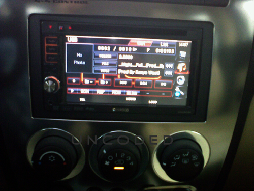

What Do you think guys?
**My Kenwood DDX5032 Features:
1- Bluetooth phone connection
2- On board TV
3- USB/I POD player
4- on board Garmin Navigation system
5- DVD-Divx Player
6- Rear View Camera

Looks good. I like the H3 logo wallpaper. Does it work with Onstar and the factory Monsoon sound system?

it works perfectly with on star and monsoown system and also you get more control over the subwoofer all you need is the harness (GMOS-4 from Metra)

That double din is a nice fit...
The TV feature. Did you have to rig the emergency brake to make it functional while driving?

how did you get the H3 logo to appear.....ive tried to load pics into mine with no luck at all and i have the same head unit.

If you load the background as the manual says then it will appear when you press Standby.

To make the unit play video while driving connect the parking break wire from the unit to the positive(live) wire from your cars harness

Sory guys for by passing the video play mode while driving (connect the Parking Brake Wire to the cars negative terminal)

I have my eclipse by passed also.
Instead of PB wire to G wire,hook it up properly to PB then tap into wire and run it to a switch(hidden but easy to get to)
This way if you have a crash you wont be more at fault for having it on.(or insurance co checks the truck at the body shop)
