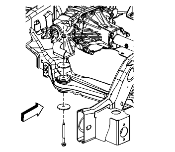

Ok I broke the bolt that holds the front Diff to the cross member does anyone have the exploded view so I can make sure I put all the washers and spacers back in the right place.

hi this is for a 2008 h2 ,but i think a 2007 is the same. The torque for the rubber mount bolt is 63ft. lbs. Hope this helps

Yep thats the bolt. I think I have all the washers. I put a grade 2 bolt in it for now. Need to get Grade 1 I think.
