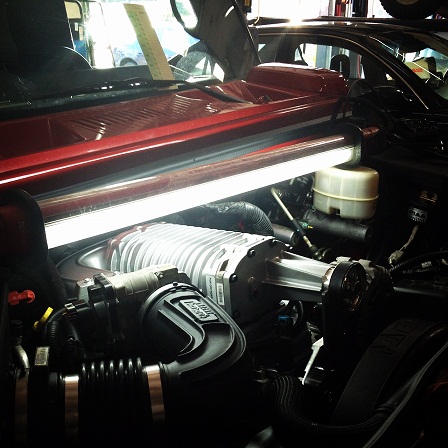

Default Re: ECM problem during Magna SC install
Finally got it in, big difference from 3k-5k rpm. Digging the "whine!" Next up is a lift/rims tires, headers, and gearing. Rancho lift plus truxx keys fit 40s no rub?
