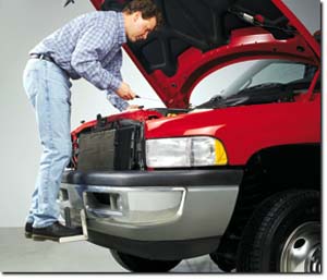

Wouldn't anything protruding from the front hitch receiver interfere with opening of the hood? Just checking.

YES!!!

B Moore: Yes to my question or happy with David's Ebay suggestion?
MAC: Check this out. "License Plate Step.
NeveRust mirror finished Stainless Steel. Easy mounting on most vehicles with steel bumper and existing license plate holes. Stainless steel hardware included. Easy No-Drill Installation.
Putco Part# 93901 $51.95"
http://www.accessconnect.com/tire_step.htm

Or maybe this would suffice?
Now one should hope the holes correspond with your license plate. Otherwise you'll have to drill some.
http://store.yahoo.com/auto-stuff/adtoforclas2.html
Old 01-10-2003, 12:16 PM
JCJ JCJ is offline
Location: Aruba
Posts: 349
JCJ is off the scale
Found it!
http://www.etrailer.com/Merchant2/00...log/p1109.html

Looks like JCJ has the bullseye hit. Thanks a million, well, thanks $26.95. Thanks to all, hope it helps many others too. Every time I visit the forum, I usually check the Tech section first and save the goodies others found on PC.
