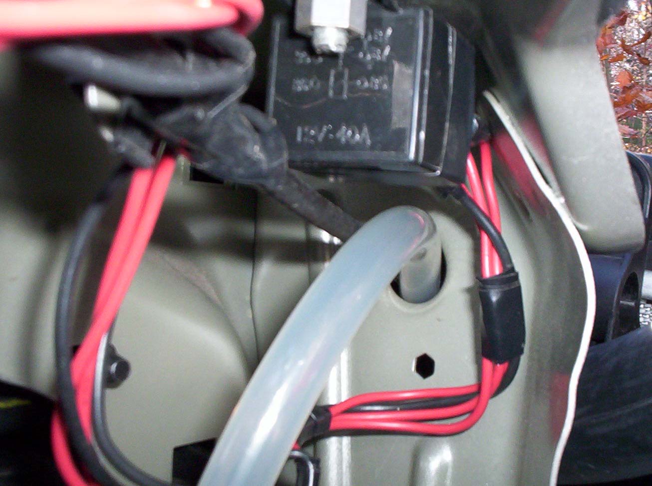

Finished installing horns.
Below are pics of instalation.

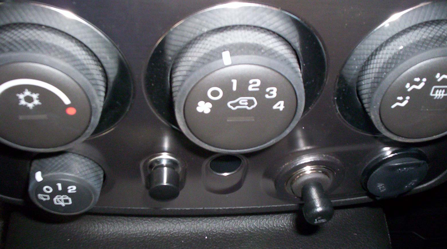

Horn buton wire to relay than to ground

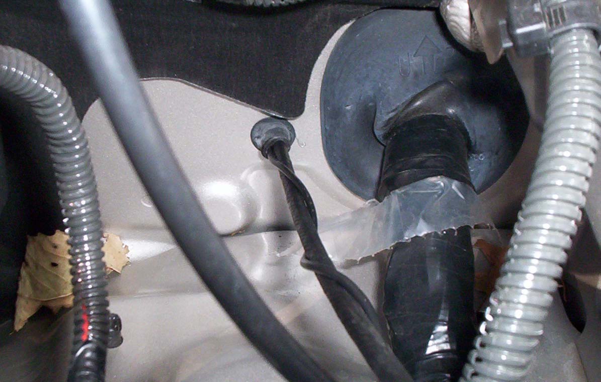

Old 11-20-2005, 04:39 PM
fourfourto's Avatar

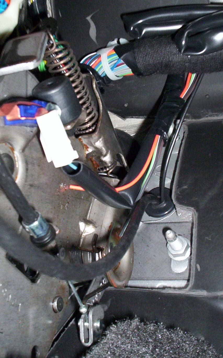

Fed wire from relay through firewall

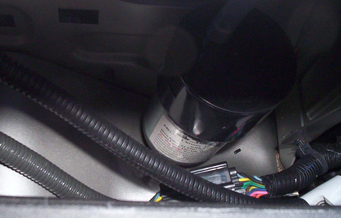

Old 11-20-2005, 04:40 PM
fourfourto's Avatar
inside view

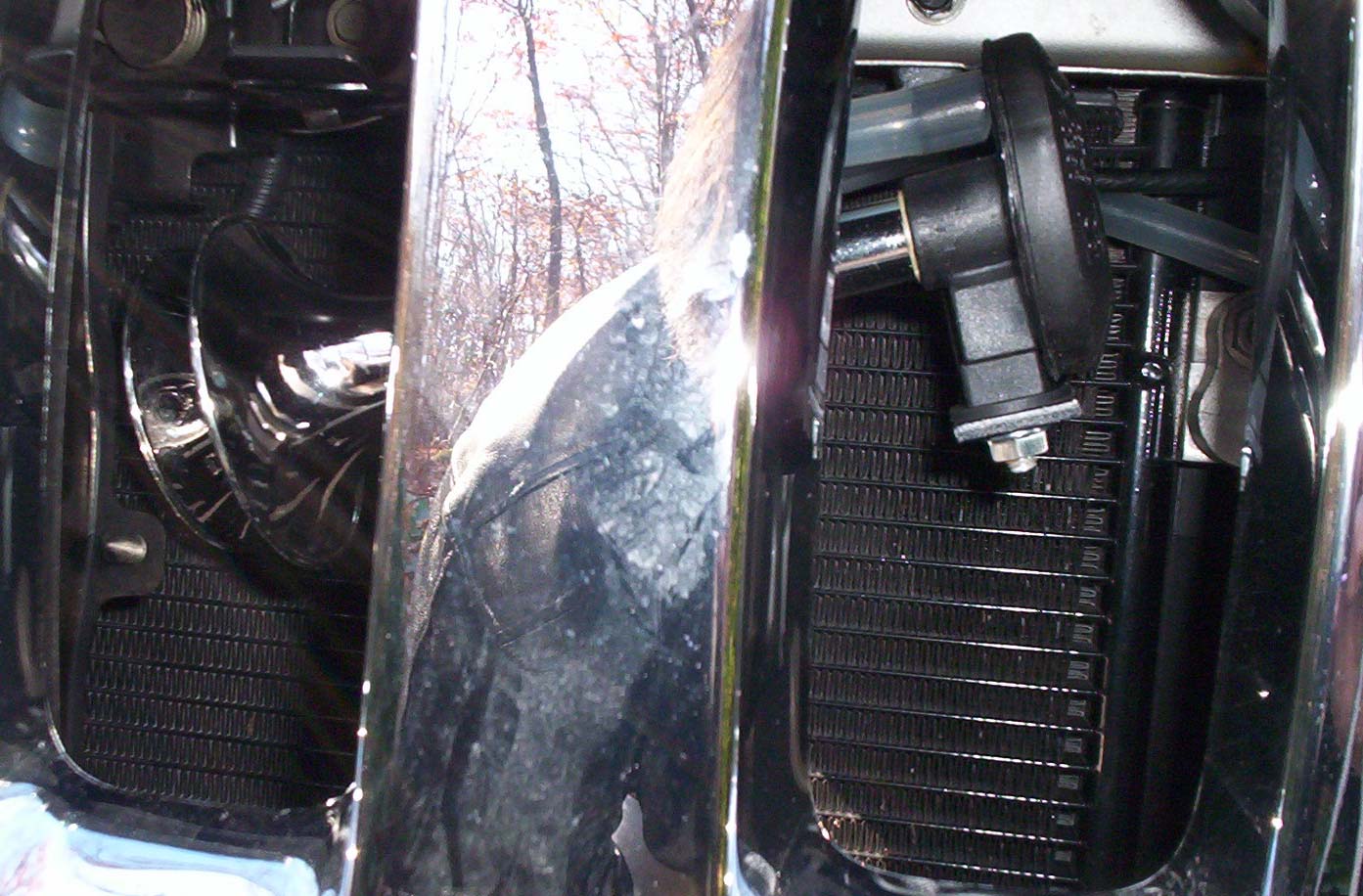

Old 11-20-2005, 04:42 PM
fourfourto's Avatar

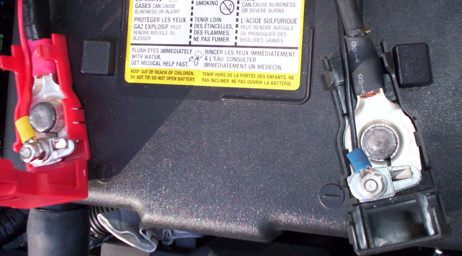

Positive to relay and ground to compressor
Old 11-20-2005, 04:43 PM
fourfourto's Avatar
Mounted relay under existing hole in front cross member.
Old 11-20-2005, 04:45 PM
fourfourto's Avatar
mounted compressor to existing square hole near drivers side headlight

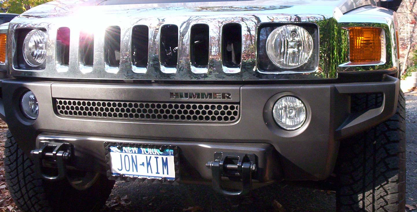

Old 11-20-2005, 04:46 PM
fourfourto's Avatar
shot of grill you can bearly notice them

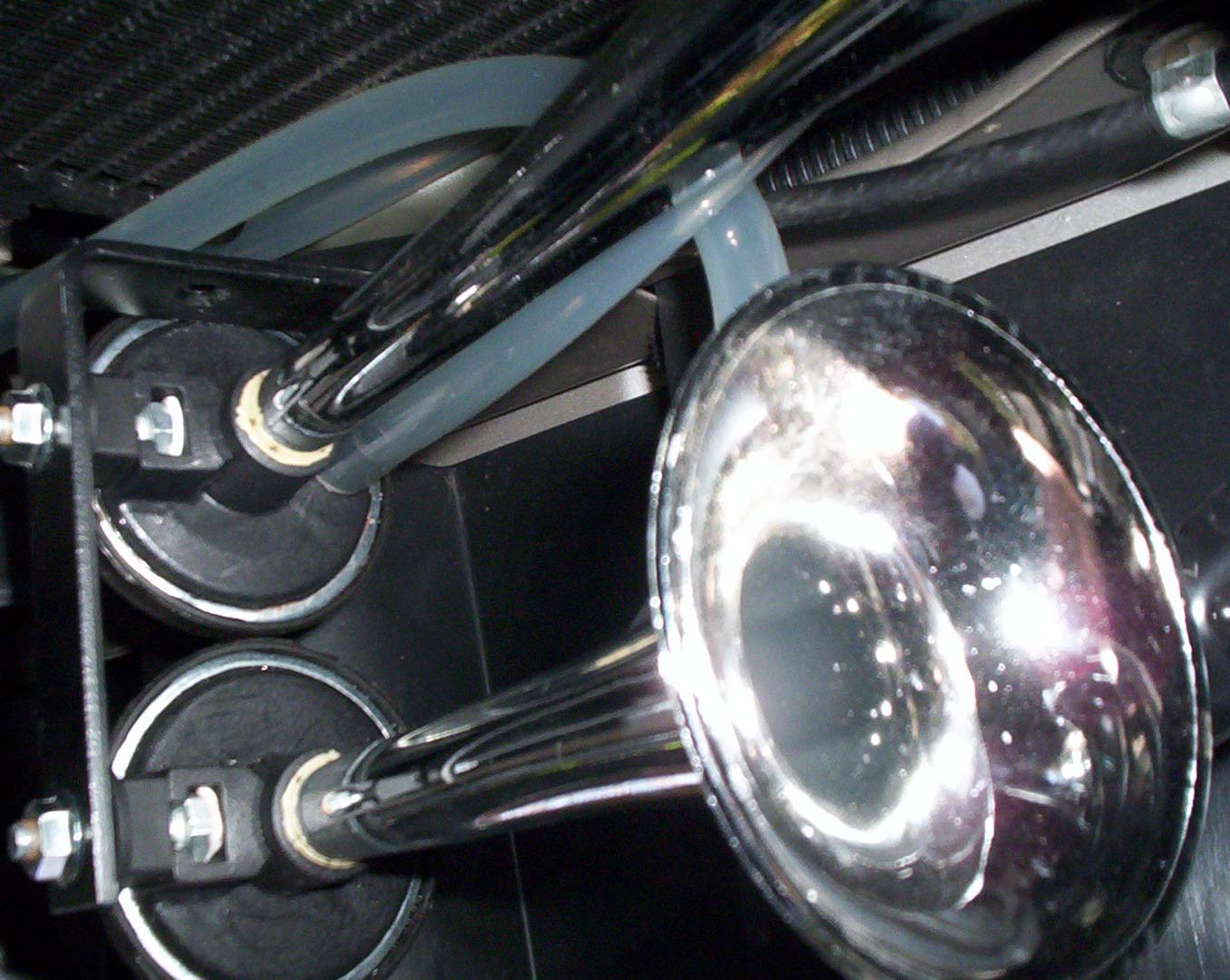

fourfourto's Avatar
close up
Old 11-20-2005, 04:47 PM
fourfourto's Avatar
inside grill
Old 11-20-2005, 04:49 PM
fourfourto's Avatar
These were inexpensive horns 135 db

Did anyone notice rust spots in the inside pic behind dash whats with that.
