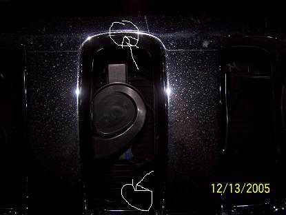

Here is a picture, looking straight at the front grill. The two arrows show the locations (approximate) of the bolts. Note that the upper bolt is a little behind the grill.

I didn't know what the round black thing was in the picture above. There are two bolts holding this down, one on top and one below. Needed an extension to reach the bolts. Hope this helps.

Thanks man, yeah its the horn, so you say the 2 horn bolts were loose?
I will check it in the am
Thanks for taking the time to take the pic for me I really appreciate it I hope this is it.
