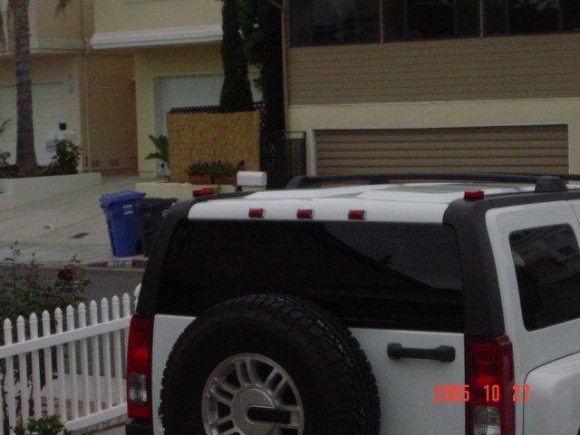

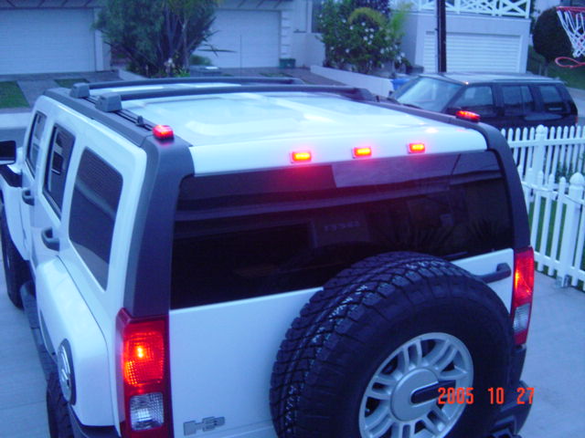

I got it all at pep boys. I think their the same kind you have except the LED one's. The small ones were 10 each and the large ones were 13 or so. The corner ones are wired down the pillars to the tail lights. The wires for the 3 center ones run down through the tailgate to the hinge side and through the black rubber boot. They stop there as I am afraid to connect them to my tail lights until I check with an auto electric place. Considering it took me 2 hours to figure out how to post the picture, I think I should check with a professional so I don't catch fire to the H3.

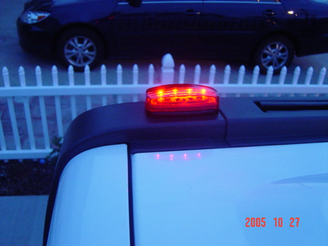

OK, the installation is complete. It took longer than I thought it would, but no wires are visible and it looks awesome. The small LED lights have a connector on the back of them so I had to not only drill holes to connect the lights but also cut a 1x1 hole for the connector to fit into behind the lights. Drilling into the truck was kinda scary, but all is well and everything is waterproof. Also, I didn't like the white on the larger corner lights so I painted them with plastic paint before the permanent install. Anyway let me know what you guys think. I past a guy in a red H3 today and he almost broke his neck trying to figure out how the lights were mounted.

another

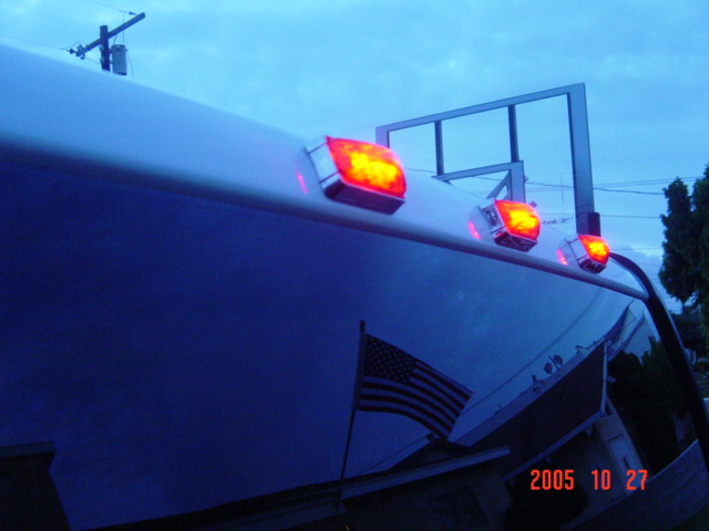

closer

another closer

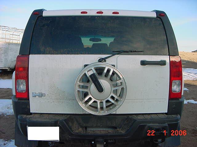

Originally posted by The Green Lantern:
I still have to figure out a better way to mount those lights, right now I used double sided tape.
Selftop screws could work, But verall it looks great man..

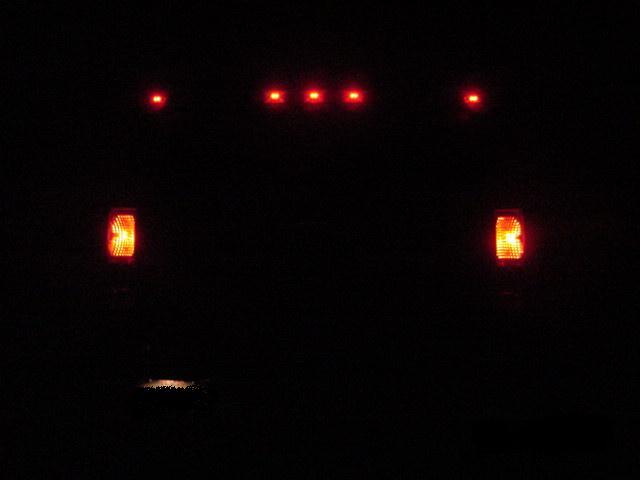

Did anyone install rear roof lights to their H3 yet? I wanna see pics please....(clearance lights like the H2's) thanks.
And here they are during the night.
