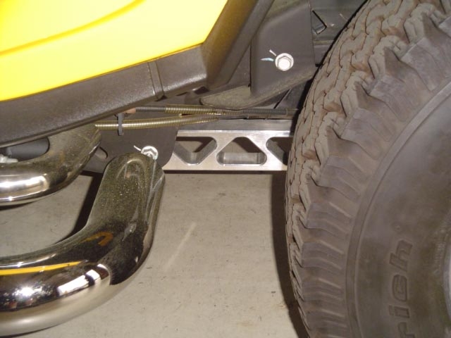

Phil,
Are these things really worth adding, any noticable difference, worth the money, etc.?

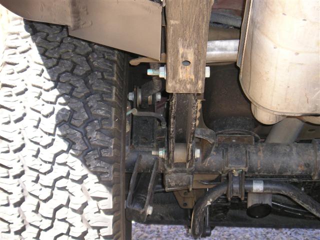

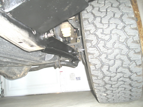

Tom, I reinforced my stock trailing arms. It cost $6 or $7 bucks and took about an hour. I used 3/8 or 1/4 (I can't remember now) steel angle and welded them into the stock arm at an angle. It was quick and easy and they are tough as nails. They also provide a great surface to slide on. In the picture it"s kinda hard to see what I did, but hopefully with the description it will make sense.
Before:

After:

Phil, any update on these new ones you tried? I was looking at Hotchkis, but it appears their zerk can get torn off when off road.

I like em! However I think If I were using my H2 offroad I would go with "KEVIN" (no harm intended) I think the possibility of rocks hitting the trailing arms might be a consideration? not to mention the cost savings... But I bought mine for the show circuit, since I use a Landcruiser for offroading.

I just bought a pair of SMA ones on ebay. They are chrome, which I am not crazy about. I will have them done with Line-x soon after Hunting season knocks the chrome off.

I like KevinB's idea of welding an angle on the trailing arm, so you now have a nice slider, and much more strength to boot!.
