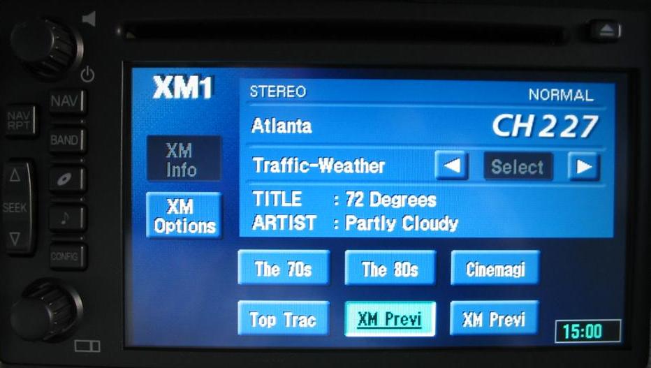

Does it still work with your 6 CD changer?
Old 11-16-2004, 10:24 PM
Klaus's Avatar
Klaus Klaus is offline
Location: CSA
Posts: 2,511
Yes, it works fine. See picture 2 on page one of this thread.

Klaus how did you hook up xm? Do you have a GM tuner or an aftermarket one?
Old 11-17-2004, 05:00 PM
Klaus's Avatar
Location: CSA
Posts: 2,511
I used the factory GM XM Kit. PM your email address, and I'll send you my install doc.
