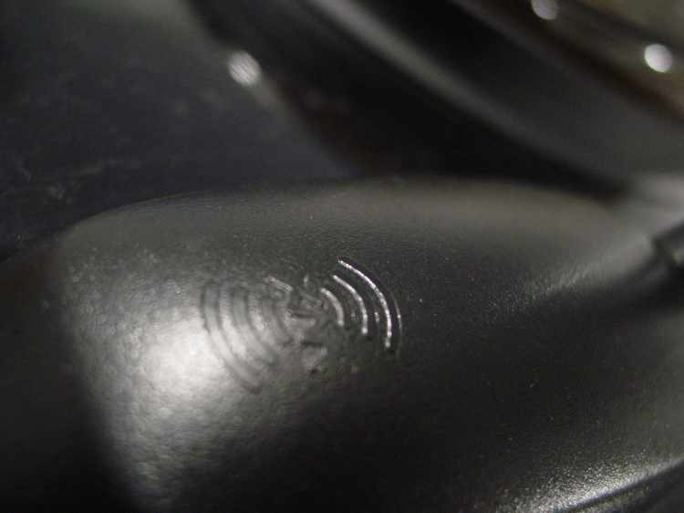

Drty, the antenna is on national backorder. Give it some time, it will get here soon enough. Of course, by then GM will probably have a kit specifically for the H2!
Here's a picture of the antenna.

Here's another picture. I'd say who sent me these pictures - But with Drty talking about midnight auto supply, I'm saving his truck!
