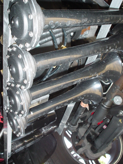

i just order a train horn for my H2 that I had on my Ram. at over 150db they will get the point when it goes off if it's hooked to the car alarm.

from www.hornblasters.com no, its not a direct replacement, it an air compressor with an air tank and 4 horns. It took me about 7 hours to professionally install one in my Ram, fabricating mounting brackets, wiring switches into the cab. Its over 150 db. actually makes your ears hurt if you stand right there. hard to describe. There is so much vehicle underneath the H2. I have laid underneath the H2 for about 2 hours mentally going over what and where i need to fit it. Only space available is right under the air suspension compresors. Going to have to fabricate several brackets, and mount the airtank in the back of the trunk because the new one is 21" long.
heres the one I mounted under the Dodge.

Some serious install time though to get one to fit in the H2 nicely. I'll have pics up as soon as I have time to install it.

Read through this thread and you'll see Dan's. He eventually went with a different tank and made some other mods.
This air blower is a monster!

Some serious install time though to get one to fit in the H2 nicely. I'll have pics up as soon as I have time to install it. </div></BLOCKQUOTE>Drop the skid plate on the front and see if you have room above it forward of the front diff.
There is a "cavity" there of open space that's sort of open from frame rail to frame rail just below the fan.

yeah, already looked, nowhere near enough room. The horn are 16" wider, the longest of the 4 horns is 21" long. The tank has to be mounted in the rear, going to mount it in the trunk area on the other side of where the jack is (on the drivers side) The horns anr going to mount right under the rear near the bumper, on the bottom ot the plate that houses the air suspension compressors, i believe.
The key to getting a nice crisp blow (huh huh huh... i said blow) is by using as least ammount of air line as possible. this way i will use 3 ft at the most.
