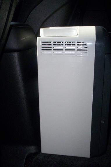

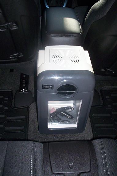

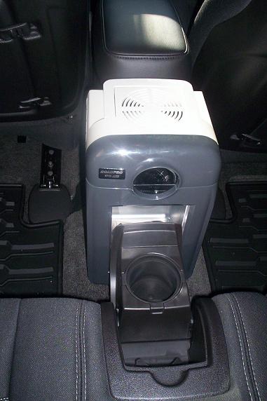

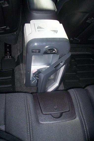

It seems to tight of a spot in the back seat.The console lid hits fridge when opening,the door only opens part way the cup holder does open .The front console is angled so its hard to mount it,I think im going to put it in the cargo area.
I think the best way to wire it is through a rap that way when I leave truck it will shut off.
Is there a rap wire near the cargo area?
I could wire it to rear outlet and use electronic timer relay but if outlet is powered all the time how would the relay reset?Im not sure how they work.Ill have to go to auto parts store and see.any ideas.
Below are several pics
fridge behind console

fridge with cup holder down

fridge with door open,notice it doesnt open that much

fridge up against console,notice top of fridge is a couple inches or so from console it would need to be attached for suport.than console lid wouldnt open enough.

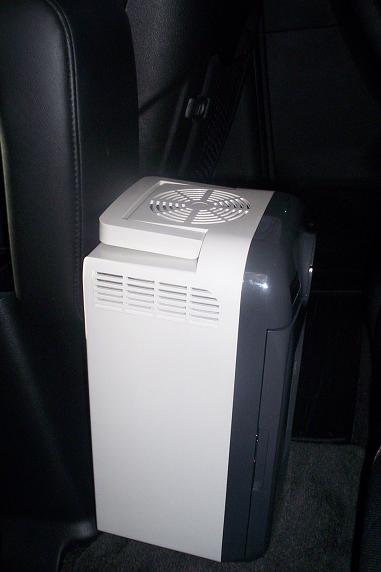

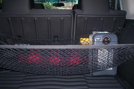

I think its going here in cargo area.Notice cord from net locked in to handle of fridge to stablize it.
Just need way to power using rap circuit so battery doesnt go dead and it will be on while driving.The manual says you can unplug and bring it with you and it will stay cold for a few hours
