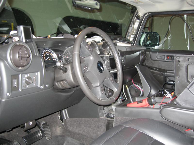

Took a drive down to Boulder City today to Radio World. What a place! It's a small shop run by a guy who was very patient and answered all my questions.
Snipping one connector is standard stuff. He didn't have the coax like the one pictured above but he did give me the replacement connector. That'll be easy to install since I already have the coax crimper.

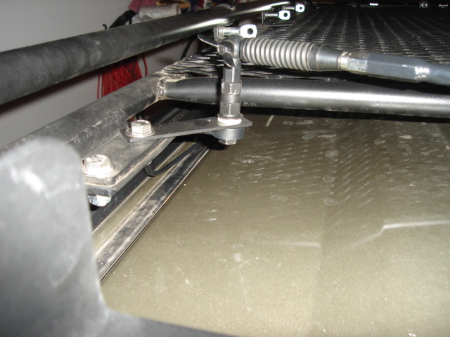

I bought a standard issue mount that'll clamp on my Gobi rack. Also and based on Phil's recommendation, I bought a swivel joint (not a spring) to put between the antenna and the base. That'll allow for laying the antenna flat for garage parking and when driving through tall brush.
I ended up with a four foot antenna. The difference in money between it and the shorter models was peanuts but the increase in range is, in the shop owner's opinion, worth it. After hearing his explanation why I have to agree. I don't know if the added length and range will every be necessary but it'll be nice to have if it is.
I also picked up a SWR meter to tune the antenna. It was cheaper to buy the meter ($20) than drive back down to his store for the free tune, which he did offer.
Here's a different take on coax length: The gent at the radio shop (he's been a ham for decades and playing with CBs since Smokey was a bandit) said that length is not critical. He said the coax needs only be as long as it takes to reach the radio. He did advise I have the install nearly finalized before tuning so I expect the coax length will impact that.
Thanks again everyone for all the assistance. I'm off to the garage to install.

Two questions:
1) Has anyone run the coax through the REAR marker?
2) Phil, how did you ground the rack?

I think it happened when the lights went on the Gobi. I didn't do anything else to ground the rack and I don't think the normal rack install would do it. I checked for continuity between the rack and a known good ground spot and it was 0.00 on the ohmeter.

As a HAM since the fifties and a commercial 2-way shop owner for 15 years dealing in low band VHF (39mhz) and CB as well as high band and UHF, here is some info.
If you have a properly grounded vehicle, cable length is not a factor, in fact at low power CB shorter lenghth is an advantage. You are attempting to keep the resistance of the cable balanced with the radio and antenna to get maximume power transfer.
Grounding: Must include grounding the antenna to the roof, if you are using complex mounts with open ground brain from the coax, an additional short length of copper braid, flattened and attached between the antenna ground screwed with star washer into the roof and sealed with silicone or other water tight seal will help. Body ground, you also should ground the body metal under the vehicle to the frame using the copper braid and weather sealed.
Last but not least, ground the negative post of the battery to the frame in the same manner. The regulare vehicle electrical ground is not all that solid and needs this extra solid ground. In all cases wire brush the surface area and clean with alcohol. On more help is to ground the tail pipe to the frame. It can cause electric noise.
Power, it is alway best to run a "home run" positive and negative cable * or 10 gauge from the batter to the radio. If you hook up to any other vehicle electric you will get noise. Vehicle electrical systems have very poor RF suppression. Check with your local sound installer. They always connect direct for noise suppression and heavy power need.
Tuning, the previous post is correct, the antenna must be in use condition when tuned. One thing many people forget when tuneing especially when the mount is over the drivers door, close the door.
One last thought, the Firestick is a great antenna because you can tune it easily and retune it any time you add something to the roof a9lights, bars etc). The rule for antennas is the longer the better. The 4' Firestick is the best comprimise for a low profile, foldable antenna.
In radio, every little thing adds up to major difference in results. You can short cut it if you don't care about the extra distance or clarity.

There is a difference between Electrical Ground and RF Ground. The VOM reads Electrical Ground. You need more expensive test gear to read RF. The best and cheapest this is to be sure that you have good,Clean (wire brushed or dremmeled), tight physical ground connection between the antenna and the ground surface. Something I forgot in my other post is that you need a good physical ground between the Radio chassis and the vehicle chassis. The can be acheived if you have a large screw on the back of the radio or drill a hole in a clear area of the back plate and, in either case attach a flat copper braid or flat copper strap with stainless steal nut and bolt or replace the chassis screw with stainless screw and stainless star washers. Seal the connections with RTV silicone or Plasti Dip. This seals out moisture and prevents the hardware from working loose. If you don't seal them, check them for tightness monthly. A ground that is not very tight can cause static interference. It may look tight, but tighten it to be sure. The copper strap is the best grounding material because RF travels on the surface of the copper not inside and strap has more surface area. I mentioned tailpipes before. The are a leading cause for noise in ham HF (CB frequencies fall in that range) frequencies. When grounding tailpipes it is best to use a stainless steel pipe strape to secure the ground and use a high temp sealing material.
One other point is to solder all connections, no clippies.

One thing I learned today: coming down the left A-pillar is a whole lot easier than the right. There's lots of open space under the driver's side of the dash. Not so on the passenger's.
