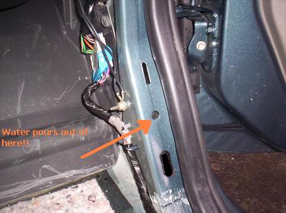

So, I am looking at the inside of the door frame now. The two bolts that are attached to the door stop hardware (just above the wiring gromet) Seemed loose...so I tightened them down a bit.
I then ran the hose for about 1hr on top of the roof. The water was only going though the channel at the top, and not hitting the sunroof at all as I did in the other tests. It did leak, but not nearly as much. I then took off the door gromet on the Hummer side, not the door, and filled the inner lip with RTV, put it back on and sealed around that with RTV. For extra measure, I put RTV around the bracket I tightened in the first place. Now to let it set, and I will try it all over again.

Old 04-04-2005, 03:19 PM
Location: The Green Mountains
Posts: 2,823
VTSTOMPER is off the scale
pic

pic </div></BLOCKQUOTE>Sounds like you're making progress. At least you've isolated the problem. You may have to look at the seals under the roof rack channel.

If those door grommet seals are not tightly
sealed it will pour water in. Take a good look at that, especially if the leak started after someone was messing with it for some reason, (running wires, etc..)

Hummertech,
Thanks for the advice. I think that is what it was...yet there has not been anyone running wires. I think the factory fit is not that great seeing that GM made all the water run right down through there. I had an ice storm here about a month ago..and the area between the frame and door had a large build up of ice...it was pretty wild.
I am just waiting to get out of work to be sure. Then i can focas on getting everything dry and back together.

Fixed. It was the door gromet. I am happy that is over.

I took my truck in this morning to have the pad replaced and the carpet cleaned. They are going to look at the floor when the carpet is out to see if there is any other sign of leakage there. After reading your posts I am going to ask them to seal the door grommet for good measure. I値l be puddle hunting soon.

I picked up my truck this afternoon. Cerritos HUMMER re-sealed the floor plug, sealed some seam along the door pillar, removed the AC box and sealed something around there (then had to recharge the AC), and replaced the rubber seal around the door. They say it was thoroughly checked for leaks with the carpet and pad out and they seem confidant that it should not leak. Unfortunately they did not seal that rubber boot around the wires in the door pillar even though I asked them if they could. I told them yesterday that I had heard of others finding that to be the source of their problem so I thought they might put some sealant there for good measure, but no.
I did not find the foam under the pedals to be wet so I did not think the water was coming from the firewall area and they said the same thing. So hopefully the grommet up there isn稚 the source.
