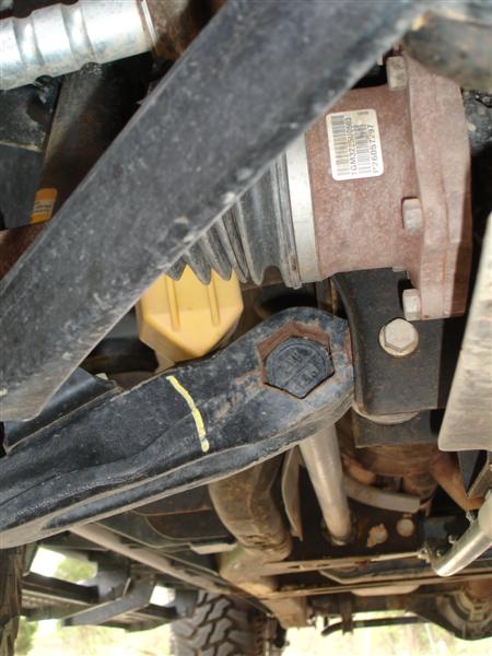

Okay, I can't post photos, but, now that I'm basically level, I assume the jounce bumpers should look about the same.
However, the point on my passenger-side jounce bumber is touching the control arm about 1 inch inside of the mark where it came from the factory. The point on my driver-side jounce bumper is pointing just a tiny bit to the OUTSIDE of that mark and is about 1/2" above the control arm (there is a 1/2" gap). What does that mean? Sounds bad to me, but I'm just guessing.

I've already been informed by a couple of knowledgeable people on here that this is probabaly not a real big deal, and it seems even less so after 3 cabernets and 6 Bass Pale Ales, but for completeness sake, here's the two differing jounce bumpers:

Driver side:

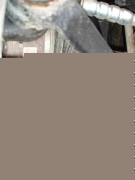

Posts: 2,061
Driver side:
Oh, never mind:
"Error
There was an FTP (file transfer) error. The detail is 'Upload to '/testdir/test.txt' failed. Detail: '552 Transfer aborted. Disk quota exceeded''."
I just posted a 69KB phto and five seconds later, I can't post a 49KB photo. Interesting.
At least on that last photo, you can see my bada$$ FT Tie Rod I got from TrailDuty!
