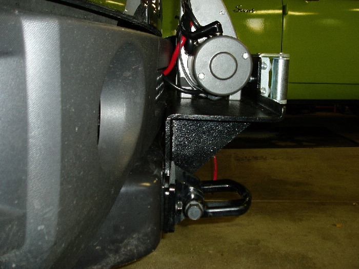

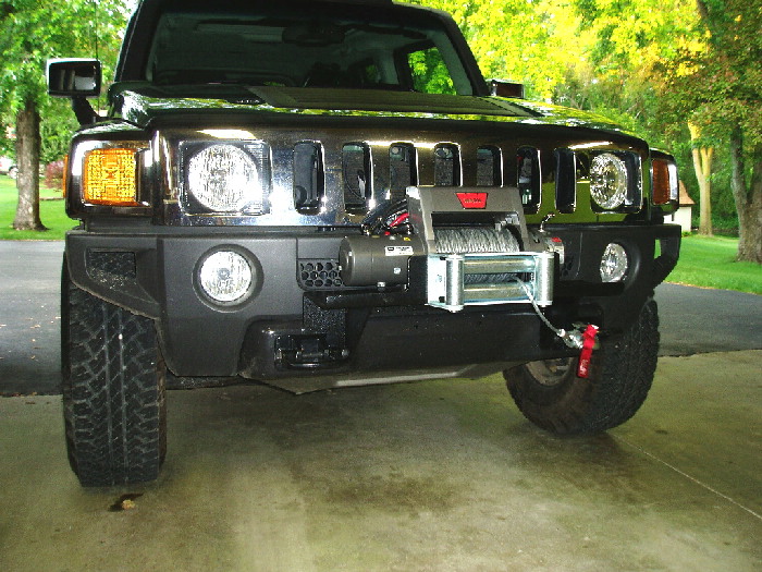

Ok, lookin' for some feedback here. I've been stuck in the mud too often lately, and needed to put on a winch. Nobody was getting around to it, so I took the bull by the horns....I designed this winch mount for my H3, just put it on today...and I can have more made. I'm not trying to sell anything here, just looking to get some ideas for improvement. When the design is finalized, this thread will move to the For Sale section.
5/16 steel, high enough to allow for front license plate, no effect on approach angle, fits with or without OEM brush guard. Laser cut, coated with Rubbergard. Sandwiches behind D-Ring mounting blocks, existing bolts have lots of extra length for installation.
Still gotta go get my truck buried in the mud & test it, but I'm pretty sure this is the optimum setup. Gussets should hold the structure just fine, I'll make sure it doesn't bend under a hard pull.
My buddy's got a big machine shop, he made this & can make more, but design may change slightly...a bigger lip in front will make the bend easier, things like that.
The question is, should I have more made if testing proves the strength? Does anybody have any ideas to strengthen it? Am I on the right track?
Pics included, will post more, and taking better ones tomorrow.
Cris Burkhalter
Green H3, a little bling, Adventure pack, BVG rack, light bar, Warn 9000
1965 International Scout, Lime Green.

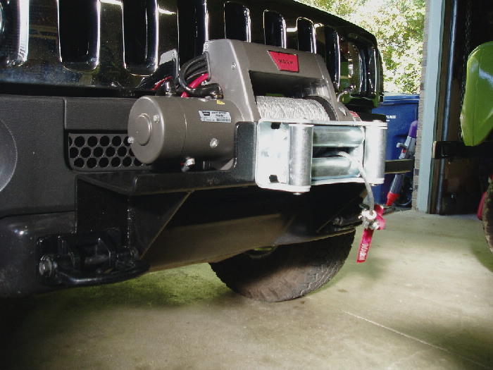

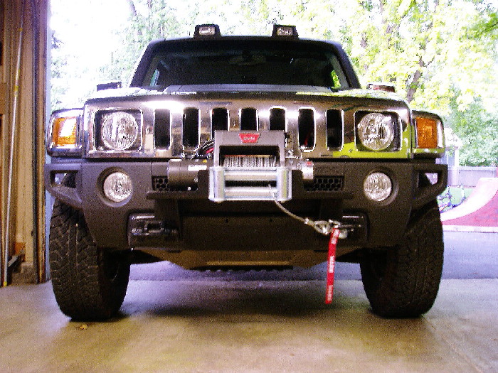

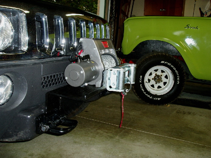

More pics

Nice work Cris.
I would have been initially concerned with hinge action on your setup, but the reinforced 5/16 material looks pretty rugged. Another thing I like is the easy access to the spool. Is your design a viable option for rigs with a brushguard? Let us know how your tests fare.
I'm partial to the DOI winch bumper myself.

Very nice Cris.
That's the type of setup I'd like if I get a winch. Same idea as the Steelcraft and Rough Country ones. I think the DOI setup looks great but I just want the winch to sit up higher and be more accessible.
Have you tested it with a brushguard yet? I'm curious how it will fit/look.

Originally Posted by Sewie
Very nice Cris.
X2. The hieght looks perfect for the trail.

Hi Cris -
I like what you've done here. Its a good looking setup. When you're taking better pictures today can you get one looking down from the top?
What are you estimating for a price?

Cris -
Okay, some feedback. I like the design overall but a small change would improve asthetics (IMHO) and reduce thigh bashings. Is it possible to "clip" the corners of the mount? See the red circles below:
Rob (Ipedog - Say "Ip-E-Dog")

Another view:
Remove the section in red
Very nice Cris.
x2, I'm also thinking you can have an integrated brushguard - if you can fab up the mount, and have a tubing bender, you could probably make a nice brushguard with the correct clearances for the winch. Very Nice Design!

Originally Posted by Ipedog
Cris -
Good suggestion, I'll run it by the fabricator to see if it brings up any other issues.
