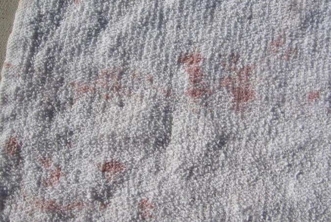

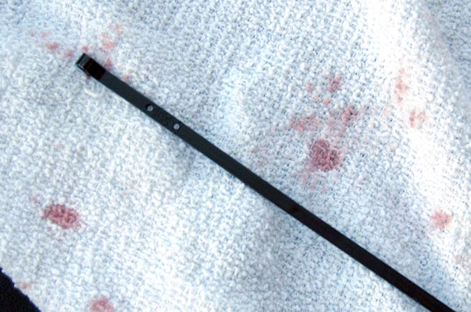

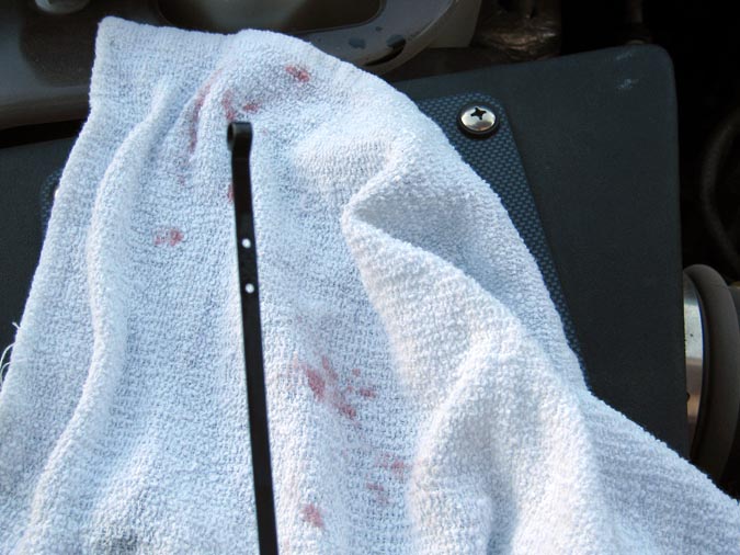

on the dipstick it says check level while parked and ideling. Ok done.
The level while not apparent in the pictures was between the two holes on the stick, the color seams ok. It's not supposed to be clear is it? It doesn't smell burnt.

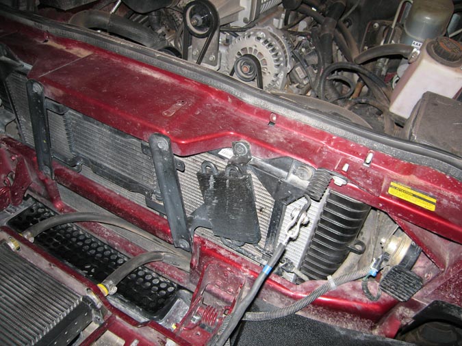

I'm pretty sure nothing else is going to fit infront of the radiator.

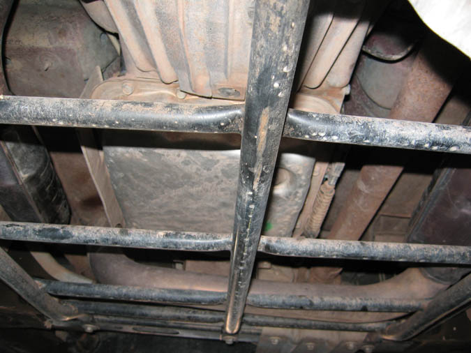

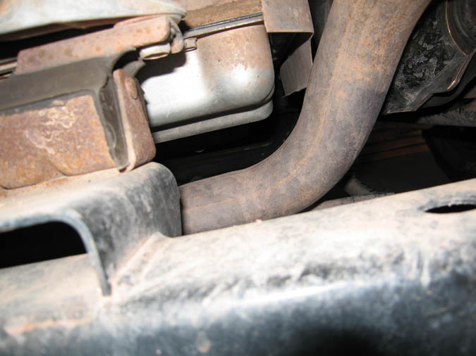

Default Re: Transmission Running Hot

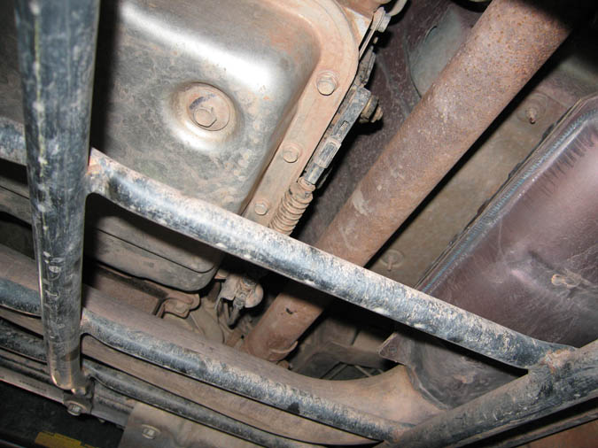

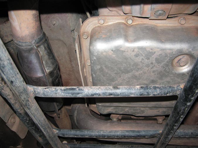

dropping the trans pan will not be a problem as the exhaust is well out of the way. There is about 5 inches between the under body protection and the pan

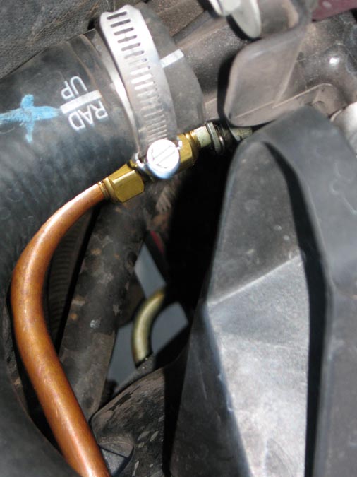

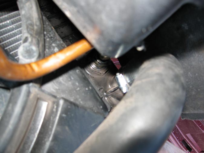

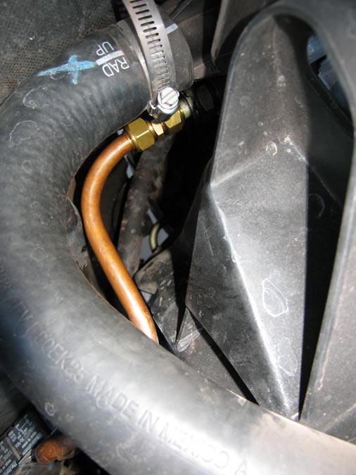

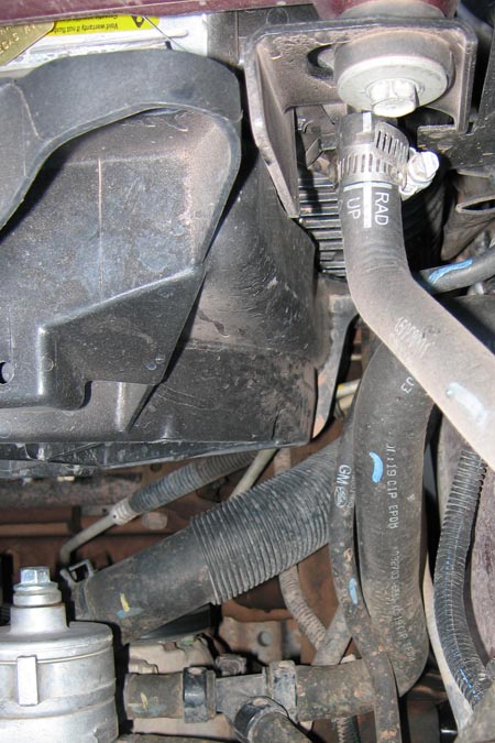

here are shots of the supply lines for the atf.

Originally Posted by PARAGON
I would fashion a heat shield over the exhaust crossover first, before I did anything else. The radiant heat could simply be cooking the bottom of the tranny pan when working hard as your exhaust temps would be running higher than a stock rig would and that would show up on an extended grade climb. Cheap and easy that might just help.
Paragon, thanks. I can see in this pic exactly what you mean. The exhaust is pretty close to the pan.
