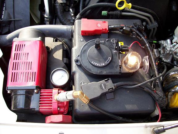

marin8703 I recieved my light .It has the suction cup
(F5 it will work on a vet or the H3 fenders )
and theres a magnet under the light .
I noticed that there are raised tabs on the bottom.(easy to cut off if needed)
Does yours have a flat surface? how did you mount the tape.
I need to pop the hood and find a nice mounting spot.
Not sure if Ill tape it or screw it.Im out of tape so I will need to pick some up.
Maybe on the top of the battery box if it fits then nut/bolt it from the underside of the box.(kinda like the compressor install.)

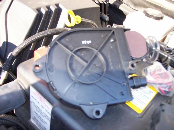

Pick of the bottom

Possible mounting spot, using flush bolt heads from the bottom of the cover
Old 12-10-2006, 04:52 PM
fourfourto's Avatar
Default Re: Where the heck is my engine compartment light?
Another angle.
Any thoughts on this spot .
It would be firmly mounted.
I dont have time to put it in today and I will be needing some SS bolts/nuts/washers and a fuse.

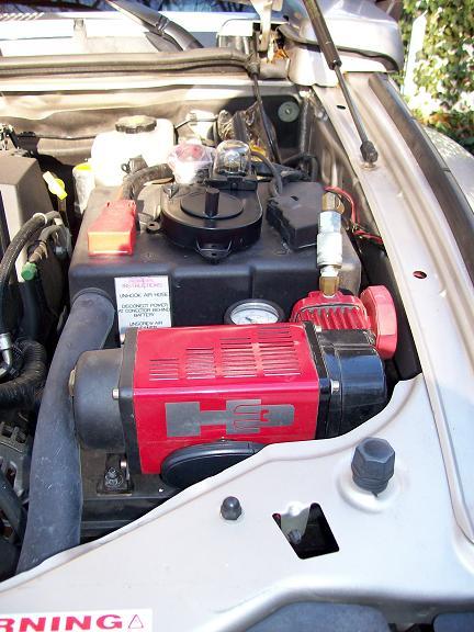

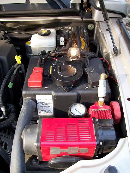

I mounted the light .On top off the battery cover seems to be a nice firm mounting surface .I mounted it with 3 flat top bolts(painted black) with washers from the underside of the cover.
I used a dab of silicone to seal it and lock tight on the nut.
A lesson learned, when hooking the battery back up make sure you disable the auto start or it starts up unexpectedly
There is a warning sticker above the radiator

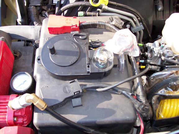

Old 12-17-2006, 08:10 PM
fourfourto's Avatar
Very handy, light cord is 20 feet long.
Unplugs easy for battery cover removal.
I also measured the factory battery
7 inches high
9 inched long
6.75 inches wide
Do they make a optimum battery in that size?
Im running out of room under the hood
side view
