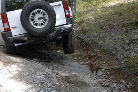

Yeah I got the ones that raise the vehicle a whole inch shorter off the ground. I also have a whole inch more travel and clearance all around in the wheel well. I can probably get over or around most things. I will have to check and see about mall parking stops and speed bumps. Since that is not where I wheel I can probably get by. Im fairly certain I will have all the travel allowed by the suspension. I have tested that. Again suspension travel and clearance is alot more important than looks out here in the sticks and rocks and gumbo. Besides my rear skids will just skate over the taller rocks. The tires have 2 ply sidewalls with a third wrapped at an angle, that is a total of three. The claws are not the same tire. They are softer rubber and do not wear well. OOps, missed the trail, what trail??

Could have used a taller tire on the right but oh no what about on the left? Is there anymore room in there? Do I always have to lean right then change tires to go back?? What to do?

OOps need and inch taller tire on the drivers side.

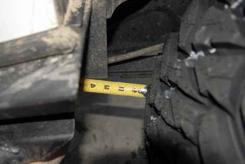

I used a little calculator gizmo on the BFG site that showed that speedo diff. Im going to run down the road with my DeLorme hooked up and see what it says. I got a Garmin around here somewhere too. Im running the 33.1 Mickey so it should not have changed much if any. The Bridgestones say they are 33. Im also wondering about rpm. I think I was running 2000 rpm at 60 with the Bridgestones.
This picture is one place I was concerned about losing clearance. Now it seems in my case it would be 3/4" closer with the bigger size in a Mickey. Leaving 2" clearance. About the size of a small rock where I go. I have wedged a rock in there already with the stock tires. When that happens you let the smoke out of the tires, and that's not good!
Oh and that was shot at F3.5
