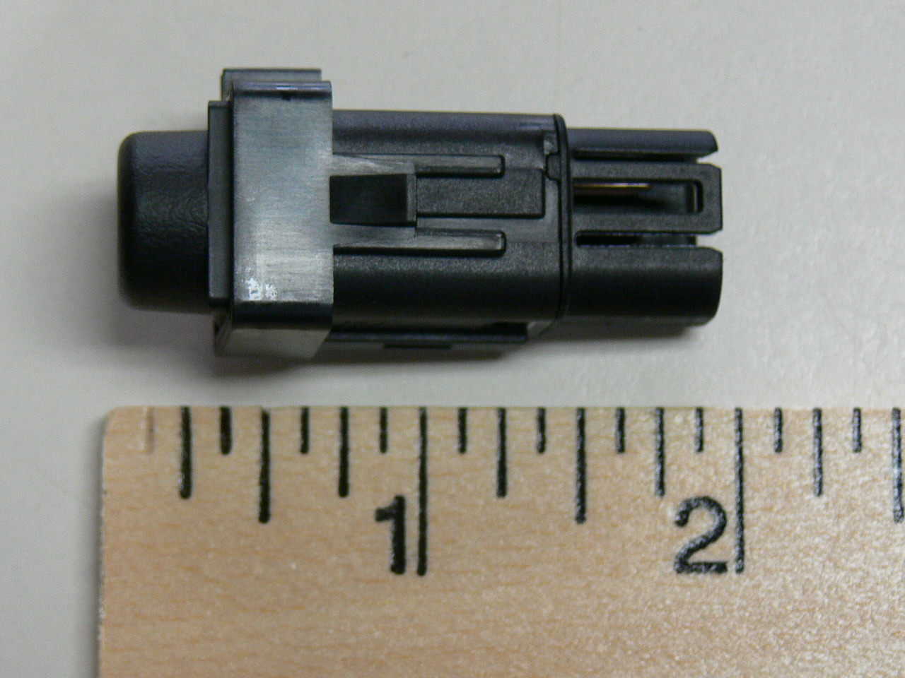

here are the pics

I have the same switch - the OEM one that you use for the overhead lights. My light also does not come on when the vehichle lights are on, it only comes on when depressed.
Actually, it glows behind the light and you can barely see it on. When depressed.
I think this is because of the third connector, I could not figure it out so I got used to it.
Sorry I am not any help, but sounds like I have the same scenario.

H3 HUMMER: WHAT DOES THE HARNESS CONNECT TO AND WHAT IS THE PART NUMBER? DOESNT ANYONE HAVE INFO?

I was wondering if that's what it was. YOu are going to have to solder a wire and connector on... unless you can get the other part to that harness.

<BLOCKQUOTE class="ip-ubbcode-quote"><div class="ip-ubbcode-quote-title">quote:</div><div class="ip-ubbcode-quote-content">H3 HUMMER: WHAT DOES THE HARNESS CONNECT TO AND WHAT IS THE PART NUMBER? DOESNT ANYONE HAVE INFO? </div></BLOCKQUOTE>
That is the problem I could not find the male end to connect to the switch so I made my own connection with Radio Shack connectors.

I just saw this, Switch 88963884 use's PN#12101864 connector with leads around.

thanks a lot partsguy. I was beginning to wonder how i was going to figure this one out. it is funny that that was the part i was going to try on rock auto. i mean it looked like it fit and had almost the same function. Atleast i can rest assured. Thanks a lot man. Ill post pics when all is finished.
