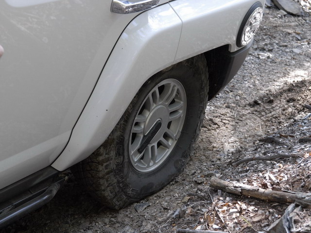

On my H3 with MTMTZ 33's with 3 ply side walls, which are 33.1 this shot is when I ran 20lbs. I was rolling over on the side wall alot and broke a piece off the edge of a couple of rims. I now run 26 in the rocks. I have one tire that got 4 slices in the side wall that run from the outside edge towards the middle. It is now on the rack for emergency use only.

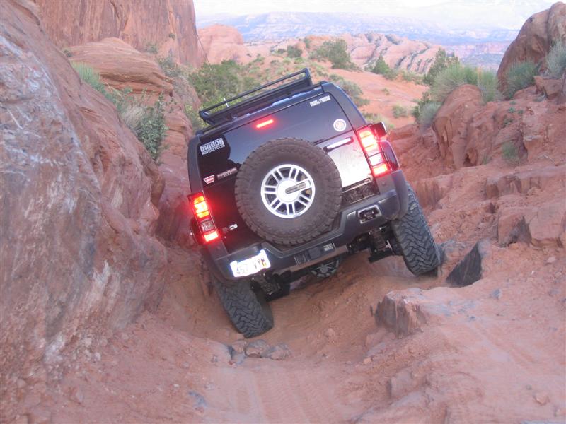

The second one is common where I wheel. Jagged shelves of shale and Ouachita stone, used to sharpen knives, stick out in narrow ravines and if you run too low with the sidwall pouched out, you get a cracked rim edge. 26lbs works for me.

There you go perfect example of what works for you. You have loose rock, wet rock, solid smooth rock, jagged rock...you cant come up with a number that works for all situations. I like to run a little bit more pressure than what I think is a safe PSI, I dont want to be stressed out while Im wheelin.
Thanks for the pics Hunner. Looks like those (bridgestones?) have a little softer sidewall then the toyos, therefore higher PSI is ideal. Would you think that to be correct Hunner?

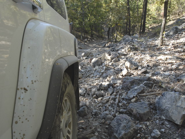

Damn that sidewall is much more flexible than the Toyo. I have read that the Goodyear wranglers are also very flexible. The pic I posted in the beginning of this thread was of the Toyos at 15. They aren't flexing over the rocks hardly at all.
I'm also glad that the rock here is not like the shale and knife sharpening stone you have there. You can still rip a tire here, but that looks heinous.

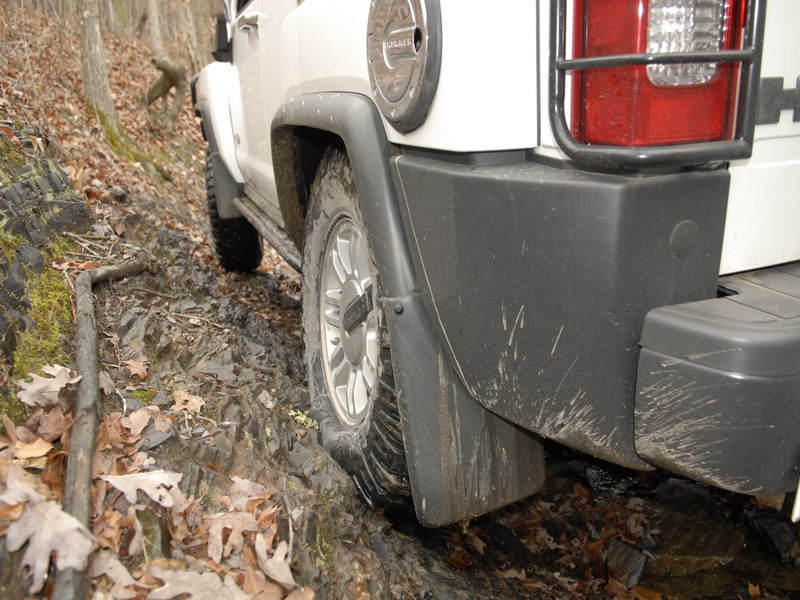

Here is another shot, with the Bridgestones and other stones in a "mine field" This is one of the reasons I decided on the MTmtz. It seems to be a tougher tire so far and grips on those side lugs which protect the sidewall. Guess I got over the new and have not shot many new "tire shots" oh boy now I have a mission..............oh and the Mtz got into those flares so I had to take them off. The side lugs rubbed in these conditions. They also rub my front sway bar in certain conditons. Thus Im glad I did not go for 35 in this tire.

Sorry but I found a shot of the Mtmtz with 26 so I thought some might like to see that. I like that amount of bulge to protect the rim but not much more.

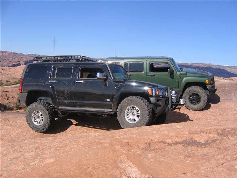

11psi
