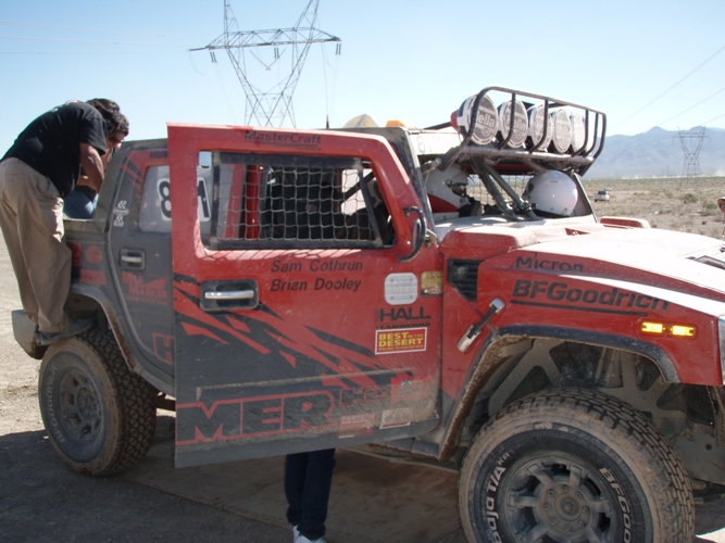

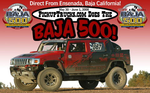

ok look at these 2 and tell me which one is close to stock?

sorry those pics are small but you get the idea

Yep, we know what you're talking about. The Dakar rig is a built from the ground up as a unique platform for racing, and has nothing at all to do with any HUMMER, except for some slight resemblence of an H3 on bodywork. Personally, I hate it, why put the HUMMER name on it if it's not a HUMMER. That's precisely why Rod Hall racing will always have more respect from me, they use stock trucks with very little modifications and give the HUMMER name some truly worthy wins to be proud of.
So yes, for your answer look to Mavericks response, the Hall Racing HUMMER's are all production line H1's, H2's, H3's and modified only for endurance and safety.
